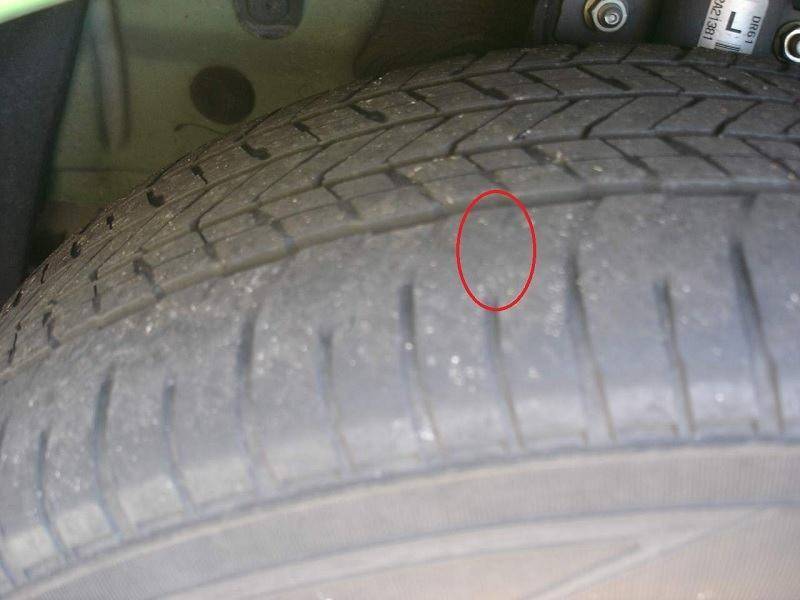

When I got an oil change at my car dealership, I was told that my car needed new tires. I've had them since I got the car 40,000 miles ago. They said that they were "in the red", which I took as meaning they needed to be changed immediately. Well, when I got the car home, I looked at the tires and they all looked fine to me. My front driver's side tire seemed worn more than the others, though. I guess that's because of 99% of the time, it's just me in the car.
Just by looking at the pictures, would you say they'd need to be changed? I could understand replacing my front driver's side tire, because that one looks pretty worn, but I see no justification in replacing all of them just because one is worn a lot.
The first picture is my front passenger's side tire (All the tires basically look like this except for the front driver's side tire), and the second picture is my front driver's side tire.

I had to switch after 50 000 km so not even 40 000 miles, I am pretty sure you had better do it and all of them. Reasons? Less hassle for yourself.
Can't tell from the pictures but look to see if the wear bars are flush with the remaining tread. If you don't have wear bars, you can use the penny test in the link below.

The circled tread does look to be nearly gone. Since the wear is worst on one side, it could be due to it's wheel being misaligned. If you get new tires, be sure to get a wheel alignment, with the new tires mounted, or the new set will wear out too soon again.

You want to left and right tires on each axle to have the same amount of tread (unless you drive like a 90-year-old!), so you normally replace them in pairs unless a nearly-new tire gets damaged for some reason.
It's not a good idea to have new tires on one axle and very worn ones on the other, If you get into an emergency situation you don't want one end of the car to be more skid-prone than the other end!

What I find troubling is that your tires are wearing unevenly. Like Russ mentioned, they need to be rotated to function properly.
From the pics you posted, the second one has a band of baldness that the first one doesn't have. That may have been caused by having low pressure for a long time. Or maybe they aren't balanced right, or maybe your car has a warped chassis due to a previous accident? Regardless, it's dangerous to drive on that tire much longer. If I were you I'd get new tires.
If you can't afford it now, put the bald ones on the back. If you're going to have a blow-out, it's much safer to get it on the back than on the front, especially at high speeds.

Thanks for the advice. I guess I'll just go ahead and get them all changed. I've driven 40k miles on them, so even if I don't have to change them all now, they're probably nearing the end of their life, right?
