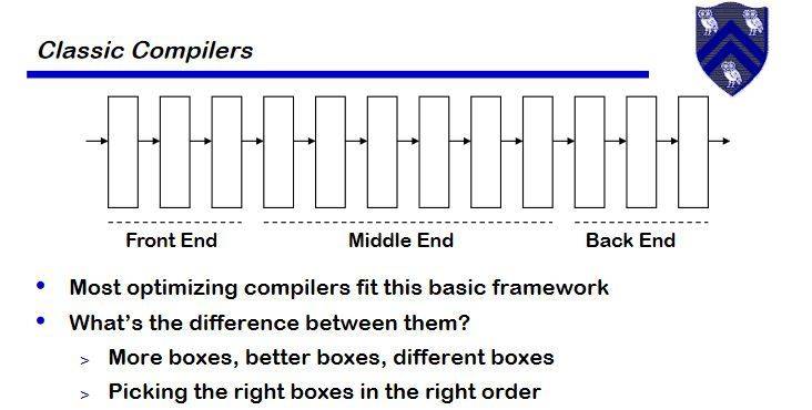

Interesting. I'm curious how far does compiler optimization go?
It depends on the compiler. The first optimizing compiler I became aware of was the FORTRAN "H" compiler back in the 60's but I don't know how extensive it was compared to modern compilers. My recollection is that it was quite good. For example, if you had a loop that worked on a variable that was not subsequently used, it threw out the whole loop (being careful to check that this would not cause unwanted side effects). If you had a statement in a loop that did not need to be in the loop, the compiler would move it to outside the loop.
Here's a good summary (at a VERY high level) of the differences among optimizing compilers:
Also, as I recall, optimizing compilers make more passes through the code than regular compilers. I used to know a lot about this stuff but I find that I've forgotten just about all of it.
Likes kolleamm and jedishrfu
