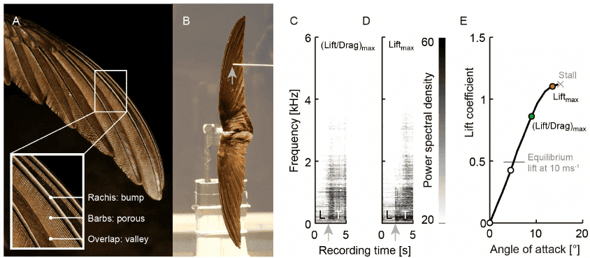

Do you thing swift birds(most aerodynamics birds; 10months in the air without landing,fastest birds in horizontal flapping flight -169km/h) have some benefits of overlaping feathers which gives rough surface?
Can planes benefits from this?https://www.researchgate.net/publication/263394314_Gliding_Swifts_Attain_Laminar_Flow_over_Rough_Wings
Detection-of-boundary-layer-transition-to-turbulence-on-swift-wings-with-an-amplified (1).png

You seemingly compared the roughness due to overlapping feathers on a swift to other birds. This isn't, as far as I know, an uncommon feature among birds. I'd expect that the shape of the wings, the fact that they can rotate them like a hummingbird, and the nature of the skeleton underneath are all larger factors.

Roughness on a golf ball works by inducing transition to turbulence. When that happens, the boundary layer is more resistant to separation and therefore the golf ball has a smaller wake and less drag. Notably, the golf ball has substantially more viscous drag, but the reduction in form drag is even larger, so it is a net reduction in drag.
Bird's wings do not feature large separated regions. They are thin, sleek, and the boundary-layer would generally remain attached when soaring/cruising. In that sense, intentionally tripping the boundary layer would only increase skin friction drag and would not do anything to reduce form drag. There are almost certainly other effects due to roughness on the wings, but any positive effect would not be analogous to a golf ball.

Who said that? There are a lot more factors that go into what makes an effective bird design than just drag. Even then, it's possible that the ridges from overlapping feathers have other positive aerodynamic effects that are less obvious. All I said is that they do not function like golf ball dimples.

There doesn't need to be a positive aerodynamic effect from this. It likely provided some kind of evolutionary advantage sometime in the swift's evolutionary history, but that advantage need not be aerodynamic.
