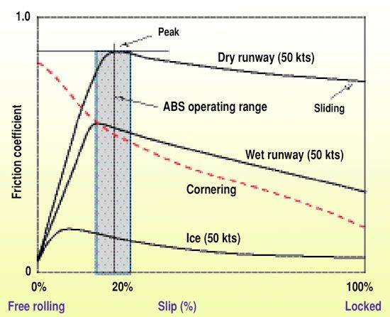

Not true. To stop in the shortest amount of time, you need to put just enough force such that the tire begins sliding, but still rolling. It's by maintaining that very critical point, each time they brake, that good drivers win races.
The following shows that you need about 20% slip to get the highest friction coefficient:

jack action said:
The following shows that you need about 20% slip to get the highest friction coefficient ...
Much of the slip percentage is related to longitudinal tire deformation (which coexists with longitudinal tire force), which is related to tire stiffness, so this will vary depending on the tire.
To clarify why several friction forces are involved in a "normal stop" (tires still rolling), note that the whole idea of braking is to dissipate kinetic energy, converting it to heat. The sliding (kinetic) friction in the brakes does this, but the friction between the tire and road (mainly static friction) does not. That's why you could roll for a long time with the brakes off - no kinetic energy dissipation! I hope that helps.
I must be getting old.
This graph makes absolutely no sense to me.
Although it makes sense as an algorithm for an ABS system, it doesn't make sense from a first term physics problem point of view, as to how to most quickly stop a vehicle.

You seem to know what you're talking about. Isn't static friction always greater than kinetic friction? That's what I remember from physics class. (It's been 30 years, btw.)
I have to admit, that I've never heard of this "% Slip" concept before, and it strikes me as more a "skip" function.
At 0% slip, the tires will be in 100% static friction mode.
At 100% slip, the tires will be in 100% kinetic friction mode.
In between, the tires, as far as I can comprehend, will be in some hybrid, hopscotchey mode.
To minimize stopping distance, one would have to be at 0% slip, IMHO.
You're correct about what the percent slip means (though it doesn't mean the tire is skipping - the rubber is deforming, allowing the wheel speed to be slower than the road speed. As for minimizing stopping distance, you do want some slip, since the simplified model of static and kinetic friction (with static higher than kinetic) is not entirely correct when applied to real tires. As that graph shows, in reality, you want about 20% slip on high-grip surfaces to maximize deceleration, and you want a bit less on slippery surfaces (you can see you want very little slip on ice, and maybe 15% or so on a wet surface). Having a bit of deformation in the tire actually aids grip.
I'm still not getting it.
"allowing the wheel speed to be slower than the road speed"
In my tiny little brain, this could happen for maybe a fraction of a second.
OmCheeto, the explanation cjl gives is correct in relating the tire's traction to the slip. Note that "slip" doesn't necessarily mean "tread sliding." When you accelerate away from a stoplight, the carcass of the tire twists, stretching behind the tread, and "bunching up" in front of the tread. The tread blocks bend too. To make a long story short, the wheel center doesn't go as far as you'd calculate from its rotation and the tire radius: x < theta*radius, because of this. Overall, the tire must deform during acceleration, so at first the more acceleration and traction force, the more the carcass twists, and the more slip - still with largely static friction between tire and road. But when you "overdo it" and the slip gets too high, the tread slides a lot, and the friction (traction) drops, being mostly kinetic at that point.
When you brake, the same thing happens, except the slip is so that the wheel center moves faster than the rotation would indicate.

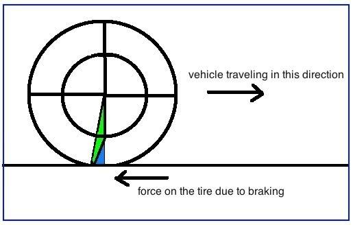

So, am I interpreting this correctly with the following image:
The slip here being defined as the angular difference between the contact surface and axis of the relaxed tire, versus the tire under acceleration? (green and or blue sections)
It is more of a static friction vs kinetic friction kind of thing. Friction forces are at maximum when there is no relative movement between two parts. When there is a relative motion, kinetic friction comes into play and the friction force is lower. The rubber-road case do not obey pure Coulomb friction theory because of the rubber deformation, hence why the peak friction coefficient happens when there is a small relative motion.

OmCheeto, unfortunately the "slip" in the reference you found is a difference type. Dislocations like it describes are a plastic deformation, but plastic deformations are permanent. While the mechanics of rubber deformation isn't elastic, it is viscoelastic, not plastic.
But I'll reiterate that carcass deflection (the fabric) of the tire is just as important as the rubber deflection.
