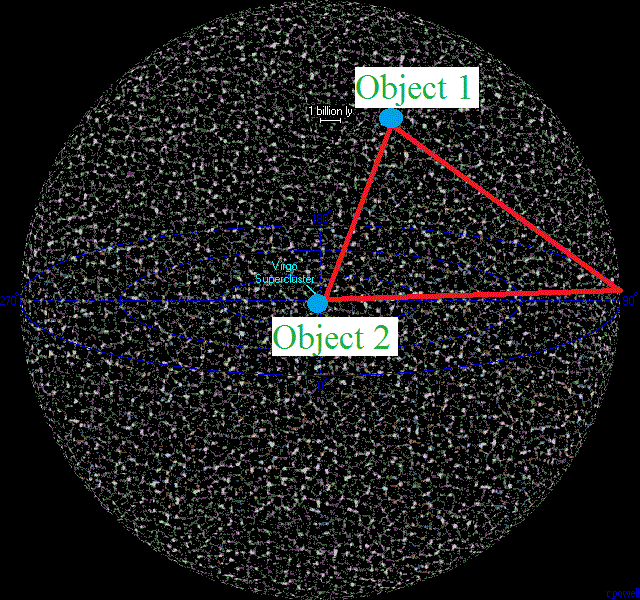

I will try to explain, if the universe were a void and even if u were traveling at the speed of light as the only object, how would you measure your movement? you would not have a frame of reference. Distance is just the measurement between two objects like you and the sun, without that frame of reference, even if you are traveling at the speed of light. Who is to say that you are were moving since that is your relative frame of reference with nothing to compare it to.
What is to say without that other frame that anything is happening? It Requires three.
The only way to could measure that in a void is you versus radius of the universe I guess.
but even that is doubtful, p would be way different in that universe. if he was moving toward that radius faster than he would be moving quicker where as if you were moving faster toward it, you would be moving faster.
