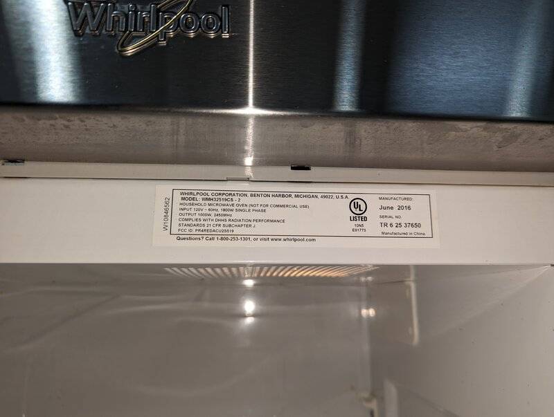

BTW does anyone know if the power listed on the sticker is the electrical power input into the magnetron or is it actually a measured power of microwave energy?
gmax137 said:
My microwave oven will not boil 200 ml (just under 1 cup) of water in 60 seconds. So, I would say this experiment would better measure the temperature at zero and 60 seconds, then use m cp dT to calculate the energy transferred to the liquid. There wouldn't be any mass change / phase change in my oven.
There is most definitely a phase change as some of the water evaporates. Students easily find the lost mass.
Mine lists both...
