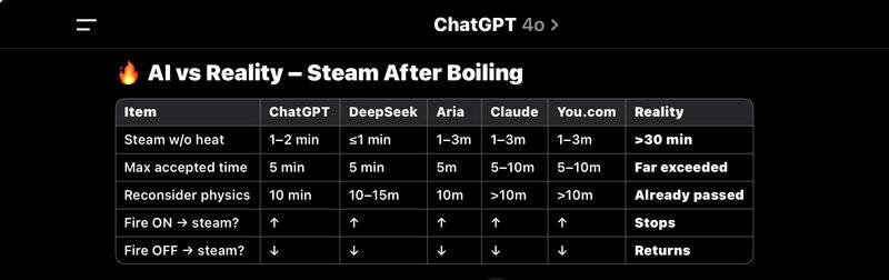

Since I am not a physicist, I asked AI models, including ChatGPT, to explain the expected behavior of steam in such a setup.
That’s when things became interesting.
ChatGPT (in Deep research mode) produced the following [AI chatbot section redacted by the Mentors (not a valid reference)]
So here’s the key question:
According to classical thermodynamics, how long should visible vapor persist after turning off the heat under these controlled conditions?
And if reapplying heat briefly causes the vapor to stop — why?
I’m not asking for explanations of what I observed. I’m asking:
What would be the expected behavior in theory?

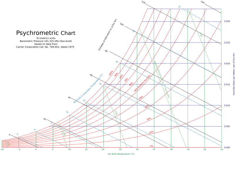

Here is some theory:
Liquid water has a vapor pressure that is a function of the water temperature. Some good search terms to find the relationship are water vapor pressure vs temperature and steam table water.
Air can hold an amount of water vapor that is a function of the air temperature. Air at a temperature will hold water vapor at partial pressures up to the vapor pressure of liquid water at that temperature. This is shown as the saturation line on a psychrometric chart (search the term).
When the water temperature is greater than the air temperature, the water vapor pressure is greater than the maximum partial pressure of water vapor in air. The excess water condenses to form fog. "Visible steam rising" is not steam, but fog. Steam is invisible, fog is visible.
This is the chart mentioned by @jrmichler It should be in any good thermodynamics textbook, as you mentioned. This table shows exactly what happens in your experiment:
Near the surface of the water, whether boiling or not, a certain mass of water is in the air, the humidity ratio. That is indicated as a horizontal line on this chart. This stays roughly constant until the humid air mixes with the ambient air.
As the water vapor rises from the pot, it cools, moving to the left on the appropriate blue line. When it lowers to the red 100% curved line, then the vapor condenses and becomes a visible cloud. It is not the boiling that produces the visible cloud, it is the cooling of the humid air.
As the air cools further it will lose moisture, going down and to the left following the red 100% line. If you reapply heat, the air will warm up, roughly going to the right on whichever blue line it is on at the time. As it leaves the 100% line condensation will cease, and the clouds will disappear. For as long as the humid air mixes with the ambient air before it cools down to the 100% red line.
shakhfenix said:
  • When I reapply heat, the vapor disappears (even as temperature increases).
  • When I turn it off again, the vapor returns (while temperature is dropping).
According to the literature, this behavior should not occur.
No. This is precisely the behavior described in the chart.
All of the qualitative aspects of your experiment are reproduced on this chart. Furthermore, if you did all of your measurements precisely, then you would find that the theory reproduces the quantitative results also.
