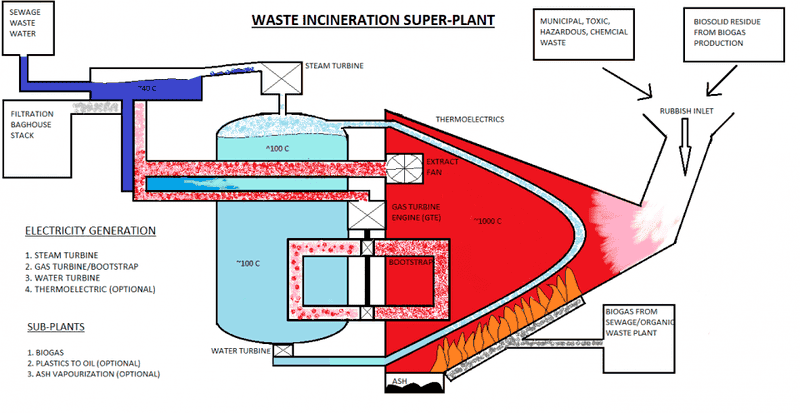

Chris1984
Some people say it's ambitious, some people say it's crazy and some people say it just won't work. What do you think?

It would cost a fortune and almost certainly be less efficient than using all the energy to make steam to run a steam turbine.
A very important principle in good engineering is called KISS (keep it simple stupid). That picture you posted is the opposite.
So are you saying it doesn't work? A complete one-stop-shop that will take all city waste and return electricity, gas and water is something worth considering I think. Electricity isn't only generated from steam, there is a GTE that governs/assists a bootstrap which also provides additional water heating.

#3 needs to be a pump, not a turbine (otherwise you can't make the water/steam circulate) and the idea glosses over what is actually needed to filter hazardous waste out of the boiler exhaust. Burning the hazardous waste is the last thing you want to do to it. Also, thermoelectrics are really inefficient and expensive, so I wouldn't bother with that part.
Also, I don't see what the "bootstrap/gas turbine" is doing.

The idea of #3 as a water turbine at the base of the Water boiler/heater is that it will generate some electricity via gravity and pressure feeding/regulating heated water into the the incineration chamber for super heating, eventually reaching super-critical levels. As for the bootstrap, it is in essence a self-sustaining system that takes advantage of the temperature differential with a turbine and compressor to heat a larger volume of water, it will be governed by a Gas Turbine Engine (GTE) for control and start-up assitance. Also the GTE is used for overall power-plant start-up and additional power-plant electricity generation, obviously the exhaust will run through the water boiler for additional heating. Thermoelectrics might be a bit far away but still worth investigating as there are some commercially available technologies.

If you use gravity to spin the turbine, you end up with water at the bottom of the boiler at very low pressure. You need something to generate the high pressure to spin the turbine at the top of the boiler. That something is a pump. I suppose you could use a pump to pressurize the feedwater from the waste, but then you are just using a pump to spin a turbine, which is pointless.
If you attach values to the pressure it will become more clear (they are more important than the temperatures, which actually tend to follow from the pressures).
If you intend to use the heat of the boiler to drive a steam cycle, it doesn't make any sense to also power a gas turbine -- one will be better than the other, so only use the better one, since you can't use the same energy twice.

The head of pressure at the height of the boiler will be quite significant considering that super-critical vapour will be directed to the top of the boiler once it has passed through the incineration chamber. This will give some pressure directed towards the base of the boiler along with gravity that will ensure water flow through the water turbine base, however most of the high pressure steam will run through the Steam Turbine. The temperature will be around ~100 C at the base of the boiler before being feed into the incineration chamber.The water boiler and incineration chamber are essentially strapped together in a closed system with the only exit through the Steam Turbine. The feedwater into the boiler will need to be pumped in, although it will have some gravity pressure assistance.The hope is that the water turbine will offset the energy requirement for the feedwater into the boiler and more.
As for the bootstrap, it will be self-sustaining. Hot air rises and becomes less dense, it will pass through a compressor where it cools and becomes more dense before passing through a turbine, then repeating the same process all in a closed system with the compressor and turbine rotating on the same spool and governed by the Gas Turbine Engine (GTE). In this process, there is an obivious transfer of heat from the incineration chamber to the water boiler. The system is a closed loop and is mostly self-sustaining, commonly and similarly seen in aircraft air-conditioning and refrigeration systems. The GTE governs and assists through a transfer drive with minimal energy efficiency loss and significant gain from heat transfer to the water boiler. At the same time the GTE provides its own electrical supply to the plant and also the waste heat runs through the water boiler, which is commonly seen in combined gas cycle system power-plants.

The boiler tube is just a tube; the pressure doesn't change from the bottom to the top except for the head (which means it is even lower at the top).
...using the boiler as the source of the energy.
The "boiler" is the place where water boils: that's the thing on the right, not the thing on the left. In either case, yes, you are using the energy from the boiler to preheat the feed water, while siphoning some off to drive another turbine. Again: unnecessarily complicated since you can only use the energy once.

I don't think it is very difficult and yes, as drawn, at least your primary cycle will not work. There is nothing in the cycle that can generate pressure to drive the cycle.
The pressure, density and temperature relationship of water and its transition to a vapour in such a system indicates that high pressure will build towards the top of the water boiler (the blue thing on the left) once the water has been feed into the incineration chamber and reached super-critical vapour.
I'm sorry, but that just isn't the case. With only gravity available, the pressure is highest at the bottom and lowest at the top. It does not increase as the water/steam flows up through the boiler (the thing on the right).

The pressure in the boiler (the blue thing on the left), will naturally have a higher pressure towards to top end of the boiler as much more heat is concentrated there. Heat rises doesn't it?

By the principle of hydrostatic pressure, the pressure at the bottom of the water tank is higher than the pressure at the top:
http://www.edinformatics.com/math_science/hydrostatic_pressure.htm
"Heat rises" does not mean pressure increases as you go up -- heck, it doesn't even mean the temperature is higher at the top.
