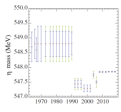

This is a real effect - no skulduggery required. You work as hard as you can, find all the sources you think of, and if you get the "right" answer you pat yourself on the back for a job well done. If you get the "wrong" answer, you go back and keep looking for errors.
The Particle Data Book has historical data on various measurements. One is below. You can pretty much see that (whatever else is going on) the errors are not Gaussian and random.
Now, how do we get around this? One way is by blinding. For example, in a counting experiment, one might not count in the signal region until counts in nearby control regions are demonstrated to be understood. Or one might introduce an offset unknown to the bulk of the collaboration that is removed only at the very end; again this is only done when various control checks pass.
Is this perfect? Absolutely not. Science is done by people.

My question then becomes: can we prevent situations like the case of particle data through time, where (at least how I understand it) researchers consistently got similar erroneous results due to using previous research as their prior while using Baye's theorem effectively? Or does using our priors necessarily lead to these issues of bias?
(Also, I know almost nothing about particle physics, but would it be possible that there were systematic errors due to measurements at the time which caused the shift? Like is it possible that in the 70s and 80s the techniques used consistently overestimated the mass?)
