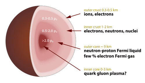

A neutron star is not a simple, naked object. It generally has a neutronium core, surrounded by a layer of highly-compressed regular matter.
That probably muddles the concept of it acting to outward appearances like a large particle.
Cutaway diagram of a neutron star showing layers from outer crust to inner core, with density labels 0.3-0.5, 0.5-2.0 and above 2.0 times rho-0, and the matter in each layer.

Did you look at the diagram above? Most of a neutron star is electrons, neutrons and nuclei.
