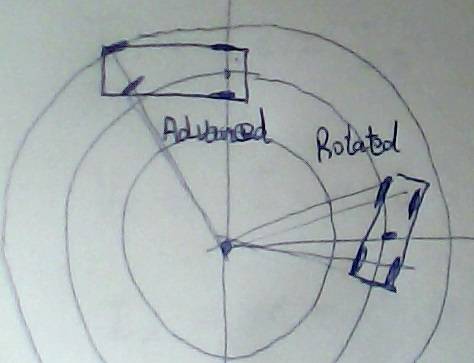

Something that does not make sense to me in that January 2016 publication, is how the radius line of the corner, passes through the centre of the vehicle, with the axis of the vehicle perpendicular to that radius line. That assumes symmetry, with both the front and rear wheels steering, equally.
See figure 1 where Yaw; Ψ1 = Ψ2, also figure 16.
I would have expected that, the radius line of the turn, should pass along the rear axle, (of a vehicle with front wheel steering). That then brings the airflow onto the front of the vehicle, from one side, while the air departs from the rear, just beyond parallel to the vehicle axis.
Can you draw this?
user079622 said:
Can you draw this?
Yes, quickly. The two situations, advanced and rotated, on the same diagram.
(Whoops, rotated vehicle should have front wheels turned).
What is advanced and what is rotated?
Advance the vehicle in a straight line, until the axis of the back axle, points to the centre of rotation of the airflow.
Rotate the vehicle about its centre of mass, until the axis of the back axle, points to the centre of rotation of the airflow.

Do you understand that a turning vehicle, with front wheel steering, has air impacting the side of the vehicle at the front, but not impacting the side of the vehicle where the back axle is mounted?
