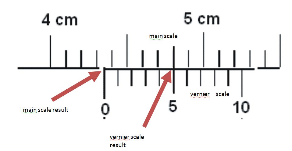

Okay thanks for all of your explanations.
Actually my question comes from the Final Test for senior high school in my country (Indonesia). The multiple choices question is :
From the image in attachment, the vernier caliper reading in significant figures rules is ...
A. 4.3 cm
B. 4.30 cm
C. 4.35 cm
D. 4.350 cm
E. 4.3500 cm
I'm confused to choose whether the answer is C or D. Or is it a kind of strange question?
of horrible quality -- partly from the jpg compression, but I suspect the original is poor too. Funny enough the center vertical line is quite sharp and perfectly aligned. From that I deduce your exercise composer expects D to be the correct answer.
The vernier scale as shown is 10 divisions over 9 mm, so alignment occurs every 0.1 mm. But here the aligment is so perfect there is no room for more than 0.02 mm deviation.
Better calipers have 19 mm vernier in 20 divisions, so alignment every 0.05 mm. And the first picture here is even better: 0.02 mm (and they claim it's the normal vernier constant: 99 mm in 50 divisions).
At least their pictures have equal thickness tick marks ...
I could agree with @BvU but adding a whole extra significant figure implies that you could actually distinguish between 4.350 and 4.351 or any other number of 0.001steps. The gaps between the lines (including the line thickness) are not regular so, despite the theoretical idea of estimating the relative gap sizes as the slider moves from 4.35 to 4.36 might suggest that you could work to another sig fig, you would really need to establish that the scale linearity is at least as good as that suggests.
For a multiple choice question with no discussion, the answer could well be D because you should always be able to do better than the 'nearest / smallest gap'. However, I remember being told, at school, to go for the nearest and take that as the answer as it gives you a reliable extra sig fig to the unaided reading. I would have to ask you what level of discussion have you had in your lessons about this sort of measurement and if it actually relates to using machine tools. I taught A Level Physics (UK) and, with the limited amount of practical experience the students got, I am sure they would find it a real challenge to work to better than the 'nearest' i.e. Answer C
@BvU It looks as though the question could be a dodgy one unless the OP can give us some context about the course he / she is studying. Exam questions are so often of poor quality.
A. 4.3 cm
B. 4.30 cm
C. 4.35 cm
D. 4.350 cm
E. 4.3500 cm
I'll wager that the exam authors are claiming that D is the right answer.
There's no doubt the reading is between 4.349 and 4.351, and it's closer to 4.350 than it is to either 4.349 or 4.351.
First of all, forgive me if my question is lacking in detail.
Allow me to confirm what I have learned from this thread.
Because the poor of the question and we are forced to choose one answer, if the line of main scale and vernier scale is perfectly aligned, the answer should be D. If the vernier scale line "seen" aligned with one main scale line, we "forced" to choose C as the answer because we can't guarantee the 0.001 cm steps (no doubtful figure).
Is my understanding correct?

Just to be clear, being perfectly aligned does not affect the precision of the measurement or whether or not you should guess an extra digit.
I believe what others are saying is that being perfectly aligned is a clue as to what the person who constructed this problem had in mind. The perfect alignment suggests that they may not have even considered the possibility that you could tell when a vernier is aligned between readings and so could justify guessing an extra digit. I’m pretty sure they expect you to answer C.

Okay, let me confirm again. Since there is no uncertainty in the multiple choice, so the safest answer is C. But the better answer is (4.350 +- 0.005) cm. Am I correct?

Nearer a best answer (somewhere between C and D, I reckon) but not one of the options, I'm afraid. At least we can say that you have been forced to think about this problem - so it's been a worthwhile exercise for you, whatever.
The thing about a test is that to earn credit you have to provide the answer that the test authors say is correct. They don't always get it right, and many times the question itself is poorly written. I would say that in this case they did a poor job of drawing the figure.
I'm sticking with what I said in Post #11.
I would unhesitatingly put down "C" (4.35 cm). I don't guess at in between values, but that may be because I am used to inch scale verniers, where the marks are closer together, and read down to 0.001 inch (0.0025 cm). Measurements with calipers are unlikely to be more accurate than that, due to variation in angle between the blades and the object, variation in applied pressure, parallax in reading the marks, etc.
Even so, the comments about interpreting what the test author was thinking are valid. Has the class material previous to the test discussed verniers, how they work and how to use them? If not, then this is a crappy test question.
