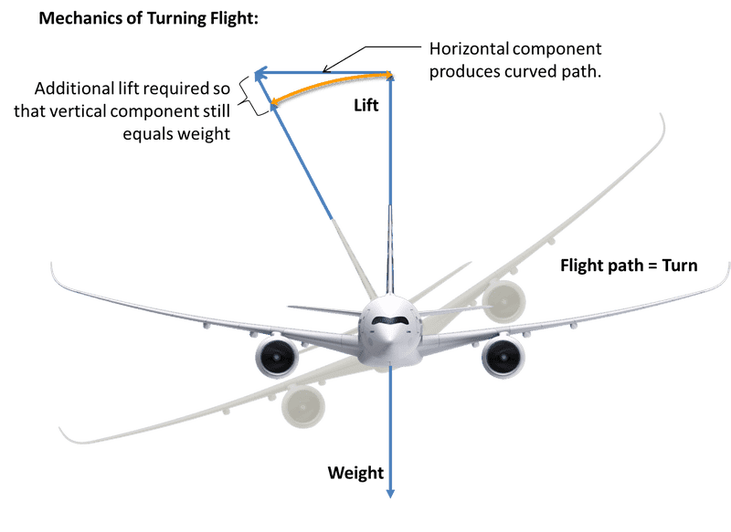

In short, to turn without loss of altitude requires the vertical component of lift remain constant.
As the plane is banked, the vertical component of lift is reduced, so the elevators must then be employed to restore the vertical lift component. If airspeed is to be maintained during the turn, additional engine power will be needed to counteract the increased lift and drag.

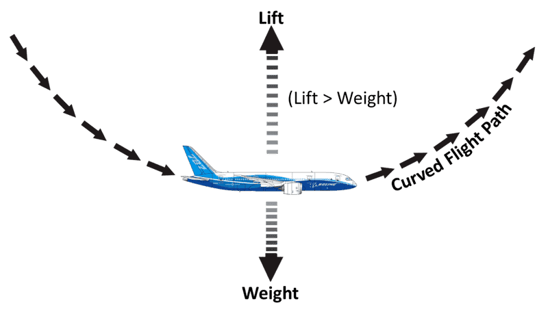

The up-elevator input induces a loop contained in the plane perpendicular to the wings, by increasing the lift as much as needed to compensate for all the above and to keep a leveled circular trajectory.

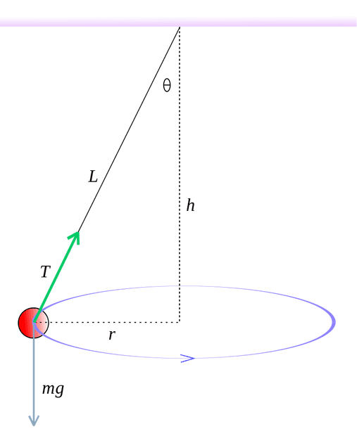

By doing so, the pilot is inducing the airplane to perform like a pendulum which mass describes a circle rather than swinging back and forth.
The lift vector then points to the imaginary spatial pivot point of that rotating or conical pendulum, while the new centripetal acceleration points to the center of the horizontal circular trajectory.
Please, see:
https://en.wikipedia.org/wiki/Conical_pendulum
Following pictures are copied from
https://www.icao.int/safety/loci/AUPRTATablet/index.html#_64
