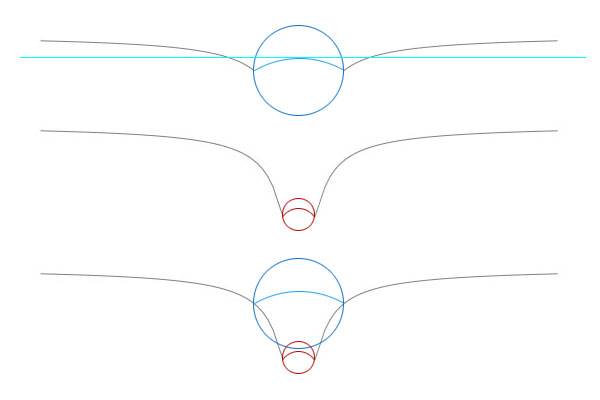

I am a very visual person so I made a diagram. Below is a side view of the classic Bowling Ball analogy of spacetime curvature. The large blue circle is the same mass as the small red one. Inside each you can see a bent line which indicates the curvature of spacetime within the planet (NOTE : I have never seen a graph of the interior curvature so I was just approximating. Assuming that the center is less but not none.) Thus one can see that the spacetime deformation does not change, except to "deepen".

I think you are on the right lines here for the curvature outside the circles, but inside the curvature should continue downwards because the potential continues to decrease inside the bodies and is at its lowest at the centre. If you reverse the curvature of the bent lines within the circles you will not be far off a reasonable aproximation of what it should look like.

I agree - inside the body the potential is still getting lower but the field (gradient) is decreasing towards the centre, so the curvature is upwards, and the minimum potential occurs in the middle of an upward curving line.

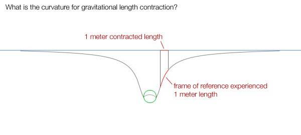

Kev,
In another post of https://www.physicsforums.com/showthread.php?t=404153" you state, "If we have an ordinary massive body like the Earth, we could in principle drill a hole to the centre and measure the distance with rulers and in that case the circumference of a ring around the Earth will be less than 2Pi*r where r is the measured radius from the centre of the Earth"
Does not this infer then that the curvature of space 'bends' upward in the center of planets? Assuming gravitational length contraction aligns with spacetime curvature.
Or am I lumping to many attributes into one line?
In another post of mine I tried to determined if the graph line of time dilation was the same as the graph lines of spacetime deformations (https://www.physicsforums.com/showthread.php?t=400908"). I only received one enigmatic answer that "It was close." Are the "bowling ball" graphs of time dilation, gravitational influence, gravitational length contraction, and spacetime geodesics IDENTICAL, SIMILAR, or CLOSE at all?
But for simplicity, one at a time, does the graph of gravitational length contraction correspond to the spacetime curvature graph? (see below...Again a little diagram).
The complication with talking about what happens to space is that it depends a lot on your coordinate system. The coordinate system is just a map. If you stretch it radially, it still describes the same thing, so the relationship of the radial coordinate to ruler length in the radial direction is a matter of convention, not physics.
The most practical coordinate system is an isotropic one, where the radial and tangential ruler sizes are assumed to vary in the same way relative to coordinate space. In that case, you can say that rulers shrink with potential (approximately as 1-Gm/rc2).
Roughly speaking, in the bowling ball model, the curve the ball makes in the surface is a representation of the potential. That is, the radius of curvature points downwards outside the ball, where the field is increasing, and upwards underneath the ball, where the field is decreasing.
However, the model is pretty misleading at best, so don't think too much about it - it is more of an analogy than a realistic model.
There are two sorts of diagram you can draw, which superficially look very similar -- a "well" or depression within an otherwise nearly-flat plane -- but which represent very different things.
The first is a diagram of gravitational potential, a "gravity well", where the slope represents "acceleration due to gravity" and height is related to time dilation.
The second represents the curvature of space (not spacetime) where distance along the curved surface represents "ruler distance" measured in space by a hovering observer, as suggested in post #9. Horizontal radius represents the Schwarzschild r coordinate. Outside of a spherically symmetric non-rotating mass it is called a Flamm's paraboloid. I don't know if it's possible to do the same thing inside a mass, but if it were, it wouldn't matter whether you drew it as a "hill" or a "hole", so you might as well draw it as a "hole" to keep the surface smooth.
