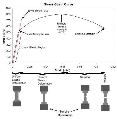

when the copper is stretched,does its young modules keep constant?
I am confused because the area will be decreased and the young modules is just related to the the material.
Do you have a stress-strain diagram for copper? The modulus is the relation between the two (it is the slope of the plot). In other words, the modulus is the stiffness. When stretched, it will remain constant for a certain range (the elastic range). Once it passes that limit, it will not remain constant.
Generic Stress-Strain Curve:
Stress-strain curve plotting stress in MPa against strain (m/m), with labelled 0.2% offset line, yield strength point, linear-elastic region, ultimate tensile strength, and breaking strength, plus tensile specimen diagrams for uniform elastic deformation, uniform plastic deformation, necking and fracture.
Stress-strain curve in MPa against strain (m/m) with labelled yield strength point, 0.2% offset line, linear-elastic region, ultimate tensile strength, breaking strength, and below it four tensile specimen sketches labelled uniform elastic deformation, uniform plastic deformation, necking and fracture.
thx!The mind is clear now,but I don't under stand the lower half diagram
