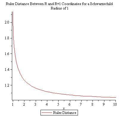

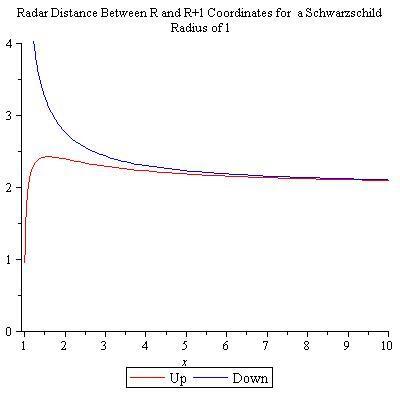

Completely agree. I added a graph to show this. If we measure the ruler distance between R and R+1 for decreasing values of R we observe that the ruler distance increases. Also, observe the behavior of the radar distance (total roundtrip time) in an additional graph.

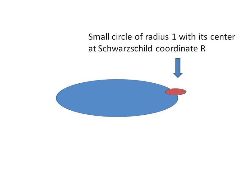

Just in case you wrote this in answer to my question then you completely misunderstood what I was asking, let me try it again but with slightly different words:
For a given Schwarzschild coordinate value Rc draw a unit circle of ruler length 1 around this point (we assume theta and phi is 0, so the circle is drawn 'flat'). What is the circumference and area given a Schwarzschild radius R0. And obviously Rc > R0.

Ok, perhaps a picture would help.
