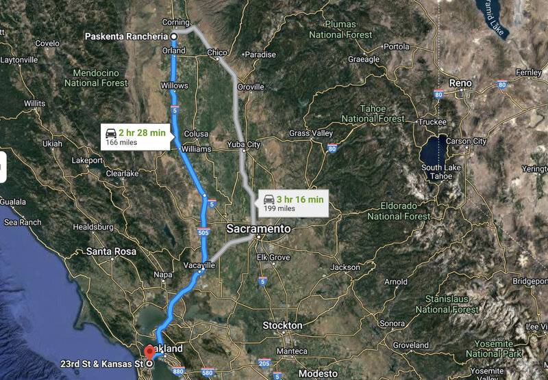

I did a Pulse and Glide test today over 339.8 miles of basically flat terrain... the "pulses" were me accelerating from 55mph to 65mph (about 10 seconds), and the "glides" were me coasting from 65mph back down to 55mph (also about 10 seconds). Speed limit was 70mph. Supposedly during the glides my fuel injectors were off because my foot was off the throttle in Drive gear, so essentially my engine was off half the time. Engine rpms were maintained at all times between 2200rpm and 2700rpm -- 55mph was 2200rpm and 65mph was 2700rpm. This took 9.42 gallons so I averaged 36.07 MPG. While this did result in better fuel economy than my 2008 Nissan Versa 4 speed automatic non-hybrid's advertised highway miles per gallon (33 MPG), it was worse than when I simply follow a big rig at constant 61mph, which results in 40.5 MPG.
Google Maps route from Paskenta Rancheria near Corning to 23rd St & Kansas St in Oakland, California, via Interstate 5 and Highway 505, 166 miles, 2 hr 28 min; alternate route via Sacramento, 199 miles, 3 hr 16 min.
(round trip)
P&G requires a manual transmission and a kill switch. The driver shifts to neutral and kills the engine at the start of a glide, then bump starts the engine for the next pulse. Pulse and Glide does not work with automatic transmissions. The engine is still spinning, so the engine friction combined with driveline losses is slowing the car down.
P&G is most useful at lower speeds. My Canyon showed little benefit from it at 55 MPH on level roads. The primary benefit was at lower speeds and/or rolling hills. The glides need to be longer than the pulses to see a benefit.
And not all cars shut off the fuel when the throttle is closed. My old Canyon would not shut off the fuel at 2000 RPM, although I have a hazy recollection that it would shut off fuel above 4000 RPM.
That's real hypermiler shstuff though. Most - excuse me - normal people will not want to turn off their air conditioning and power steering and go through the effort of the P&G itself. Point being: are you sure P&G does not work if the car stays in gear? I mean, certainly you won't get maximum benefit, but you should still get some, right?
