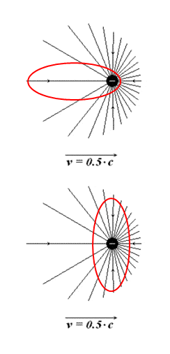

If I have a spread of electrical charges contained inside a Gaussian surface, and if I cause those electrical charges to move at relativistic speeds, the electric fields of those charges should be subject to relativistic contraction. What happens then to electric flux that cuts through that surface? Does it decrease, increase, or remain the same?
The integrated flux of E is still given by the total charge enclosed, which doesn't change.

We are no longer dealing with an inverse square law force (a basic assumption of Gauss' law) with respect to the charge location, for reasons which are quite obvious.
To show what that looks like in a diagram, here it is using the Liénard–Wiechert Potential:
https://www.physicsforums.com/attachment.php?attachmentid=43069&d=1327380412
Remember that this is a 2D diagram.
A 3D diagram would show a proper account for the area and the corresponding electric field intensities thereof.
The conservation of the integration of the electric flux of a static charge on a closed surface surrounding a fixed quantity of charge should apply even in the most extreme case where v=0.99999c, in which the vast bulk of the weight of the integration is tied to a relatively small band area, in contrast to what would be in the case for a charge stationary with respect to that Gaussian surface.
It remains apparent to me that if the field's force components do not obey the inverse square law, then Gauss' law cannot be applied, and the value of the integration will depend on the surface upon which the integration is done.
  • Lienard-Wiechert Potential of a Relativistically Moving Point Charge Bounded by a Shape.gif

Gauss's law is quite general and does not require the inverse square law potential to hold.
Gauss's law follows by applying the divergence theorem to Maxwell's equation
for div E=4\pi rho, which still holds, no matter how complicated the E field.

We have a delay in the E-field propagation, so different parts of the surface see the same charge as being in different places within that surface.
So this isn't just a complicated E-field in the sense of its distribution within the surface. The parts of the surface can't even agree on the position of the charge.
So how can you take a statement based on invariance with respect to the distribution of charge and say something to the effect that the same reasoning accounts for invariance of the electric flux integral with respect to a time-retarded electric field? I'm not able to take that leap of faith.

It has to do about whether or not electric fields undergo relativistic aberration of electric fields.
If there is relativistic aberration of electric fields, it will make a difference. That difference will be found in the integration of the electric field with respect to a Gaussian surface.
The perception I had when I opened this thread is that light-time correction would make a difference in this integral. After some objections to the idea, I also noticed that relativistic aberration would make a difference, if applicable.
I am still pondering on the likelihood that both relativistic aberration and light-time correction will make distortions to this integral that are simply not accounted for by a Lorentz-transformation.
Recently I have even found that it is assumed in physics that the electric field doesn't aberrate at all. I have only found information concerning the lack of aberration of the gravitational field, but to find such information is not equivalent to verifying that electric field is not subject to relativistic aberration, though finding that information has apparently left the impression in some that relativistic aberration does not apply to 1/r^2 forces.
