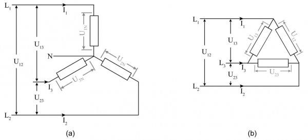

Hello all,
I'm having a bit of a difficult time following a specific conversation that I had with one of my professors. Occasionally, we would be given a 3-phase load (balanced or unbalanced), with merely the wires shown (the formation of the sources was not revealed. See the image below.
I asked what formation do we assume the sources are in, and he said that it doesn't matter. However, I was analyzing a few questions assuming wye connection, followed by delta connection, and I was getting different results; meaning that it did appear to matter.
As an example, say we are given a line voltage of 208V for a) in the image.
If we assume wye orientation of the sources, then in phasor form we would have,
[tex](U_{23}, U_{31}, U_{12}) = (208e^{j30}, 208e^{-j90}, 208e^{j150})[/tex]
All of these are leading their respective phase voltages in wye.
If we assume everything remains the same but we merely change the sources to delta configuration we get the following:
[tex](U_{23}, U_{31}, U_{12}) = (208e^{j0}, 208e^{-j120}, 208e^{j120})[/tex]
This is due to the fact that the phase voltages are the same as the line voltages in this orientation.
Furthermore, there is an actual conversion from one to the other. However, I am just not seeing how you can assume the original orientation and get the same results. Any idea where I am going wrong, or what?
Thanks!
You are varying the load and getting different currents, as you would expect.
How the supply voltages are generated doesn't matter except that if your load requires a neutral then you should have access to a neutral from the supply.
The voltages are given relative to each other and in fixed phase relationships. This is OK. You can work with that.
Just accept that the voltages are right and don't try to rewrite the problem. They only want you to examine the load, not the whole system.

You say different source configurations, but what is in the image? Source or loads?
I thought it was loads.
Okay, you have no idea whether that 208 volts was made by 208 volt windings connected delta, or by 120 volt windings connected wye.
You are only given 208 line to line volts, where did your angles come from?
All you know is the line to line voltages are 120 deg apart.
After you choose something for zero degrees reference you can assign all angles relative to that. And that choice is yours, unless it's spelled out in the problem statement.
What did you choose for zero degrees?
I'd have used one of the line to line voltages.
I think you are not consistently choosing your zero degree reference.
What if you use U23 for zero degrees in both cases?
U23 = 208 angle 0.
Then it's U1n, U2n, and U3n that'll be off by 30 degrees and have different amplitudes,, 120 vs 208.
But they don't appear outside the machine.
You will get the same line currents and voltages both ways if you are meticulous and consistent about choosing your zero degree reference.
try it out.
old jim
