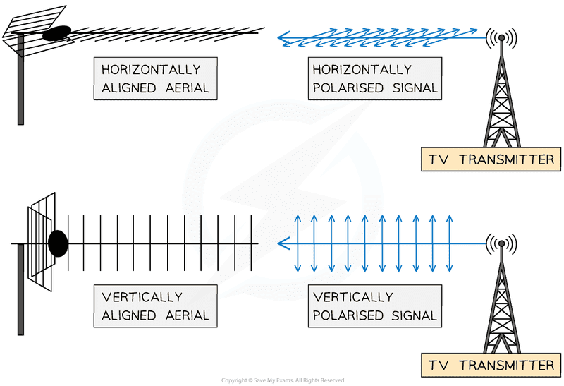

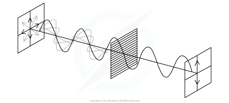

I'm confused, i thought that for microwaves / radio waves the metal grille (aerial) needs to be perpendicular to the transmitter in order for a signal to be received. But here they are in the same orientation?
Shouldnt the aerial be in perpendicular orientation for all em waves? including radio
Diagram of plane-polarised waves travelling left to right: an unpolarised wave with vibrations in all transverse directions on the left, a vertical-slit grating in the middle, and a vertically polarised wave passing through to the right.
Two diagrams comparing TV aerials with transmitted signals: top row shows a horizontally aligned aerial receiving a horizontally polarised signal with horizontal wave arrows; bottom row shows a vertically aligned aerial receiving a vertically polarised signal with vertical wave arrows, both from a TV transmitter tower.
The closely spaced metal grille is reflecting the electric polarisation parallel with the wires of the grille. Only the orthogonal component can pass through.
what is orthogonal and what is the electric polarisation from the grille. All i know is free electrons from the grille cancel out the electric field in the same propagation?

A horizontal wire antenna transmits a horizontally polarised electric wave, with a vertically polarised magnetic wave. Those waves are orthogonal, which means at 90 degrees.
https://en.wikipedia.org/wiki/Polarization_(physics)
The current induced in the grille by the EM wave, cancels the forward wave. The energy must go somewhere, so it is reflected, back towards the transmitter.

Ok i get the first part, how is the forward wave cancelled by the current and what is the forward wave (magnetic/electric field), and what does the energy returning to the transmitter contribute to the question?
homeworkhelpls said:
...how is the forward wave cancelled by the current and what is the forward wave (magnetic/electric field),...
When an EM wave is incident on a perfectly conductive sheet, the magnetic component induces a perpendicular (+90°) current in the sheet. That current in turn generates a magnetic field, again perpendicular (+90°), making a total of a +180° rotation. The sum of the incident and reversed magnetic fields into the sheet is zero. But the 180° component is reflected with the energy. Good conductors make good mirrors.
If the conductive sheet is a grille, only EM waves, polarised with the electric component perpendicular to the wires, can pass through. EM waves with electric field component parallel to the wires will be reflected.

Ok i get the reflection part and most of the EM wave passing through the grille makes sense, but
Diagram of a wire grille with parallel black lines on the left and a blue arrow pattern pointing left on the right, with a wave symbol at the far right end of the blue arrows.
in this example, EM waves are parallel to the wires and not reflected, however the EM waves perpendicular to those of the transmitter are. I might be confusing wave propagation and the electric field propagation of the wave.

Both the transmit and the receive antennas need to be oriented in the same way. The electrically conductive dipole elements of the antenna define the orientation of the electric field, which simply names the antenna polarisation.
The current, that flows in the dipole element, produces the perpendicular magnetic field.
The magnetic component of the EM wave; H, is proportional to the current in the dipole element.
The electric component of the EM wave; E = H * Zo; where Zo = 376.73 ohms.
https://en.wikipedia.org/wiki/Impedance_of_free_space
As the EM wave propagates through space, the E and H fields remain in phase.
E and H, and the direction of propagation, are all mutually perpendicular.
The H field of the EM wave induces an electric current in the receive antenna element.
That current becomes the electrical signal that reaches the tuned receiver.
