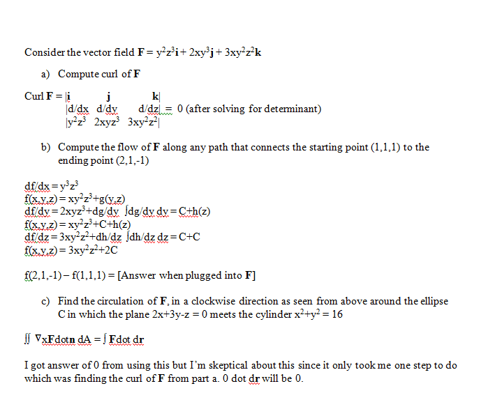

Here's my work typed in Microsoft Word:
http://i.imgur.com/jWPqBDh.png
I have trouble believing the answer is 0 for part c. All I did was use the curl of F from part a and dot it with dr which came out to be 0.
I suspect that in part (c), you are expected to actually carry out the line integration around the closed path C , rather than using the theorem (Storke's Theorem).
(An image of you work follows.)
