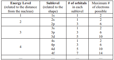

I can’t find the page in the book, but here's a chart from google. As you can see each level has n number of sublevels.
AdvaitDhingra said:
heres a chart from google
Where? Please provide a link.
The "sublevels" described in that diagram are there, yes, although "sublevels" is not a term I've seen used to describe them. The more usual term is "orbitals". The relevant quantity is not really the number of sublevels but the number of electrons. See below.

The energy level ##n = 1## does not have any d orbitals. It only has an s orbital. You have to go to ##n = 3## before you have any d orbitals.
To a first approximation, electrons in all orbitals with the same ##n## have the same energy. However, there are a number of corrections which are different for the different types of orbitals, so if your measurements are accurate enough, you can detect the difference in energies between electrons in s, p, d, etc. orbitals in a given atom. Also, the energies will be different for different types of atoms (i.e., different chemical elements).

In the most simple non-relativistic model of the hydrogen atom each energy level ##E_n=-1 \text{Ry}/n^2## (##n \in \mathbb{N}=\{1,2,\ldots\}##) is ##2n^2##-fold degenerate (##n^2## from the possible values of ##\ell \in \{0,1,\ldots,n-1 \}## with ##2 \ell +1## values ##m \in \{-\ell,-\ell+1,\ldots,\ell \}## and another factor ##2## for two spin states ##m_s \in \{1/2,-1/2\}##).
This is what's in the table in #5. Of course, in general, the Bohr-Sommerfeld model doesn't provide a good explanation nor a good qualitative picture of the hydrogen atom (which, e.g., is in its ground state not a little flat disk but a sphere), but it can give at least an explanation for the ##n^2##-fold degeneracy (because spin wasn't known at the time they didn't know about the additional factor 2) of the non-relativistic model. Already the relativistic treatment in the Bohr-Sommerfeld model leads to a partial lift of the degeneracy, giving by some accident (I find difficult to explain though) the right fine structure even without the correct notion of spin 1/2 and the Dirac equation...
