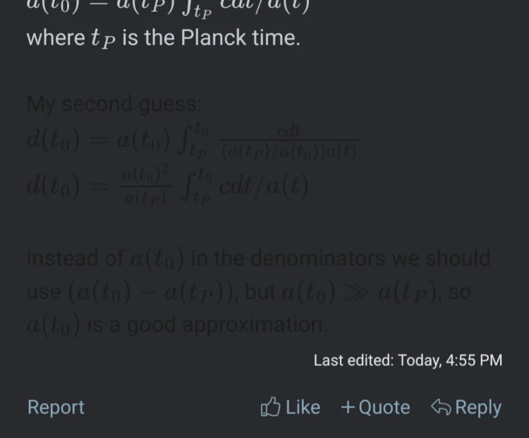

@Ibix why on earth did you delete ##a(t_0)## in my quote "Now I know exactly why the proper distance doesn't depend on ##a(t_0)## for a mathematical reason..."?
How many times the universe has expanded since - let's say - the Planck time till now IS NOT a matter of choice of distance coordinates, because it's a ratio. And I'm asking about it BEFORE calculating the particle horizon, because I think that this calculation should depend on it, but it doesn't, and that bothers me.
My first guess:
##d(t_0)=a(t_0)\int_{t_P}^{t_0}\frac{cdt}{(a(t_0)/a(t_P))a(t)}##
##d(t_0)=a(t_P)\int_{t_P}^{t_0}cdt/a(t)##
where ##t_P## is the Planck time.
My second guess:
##d(t_0)=a(t_0)\int_{t_P}^{t_0}\frac{cdt}{(a(t_P)/a(t_0))a(t)}##
##d(t_0)=\frac{a(t_0)^2}{a(t_P)}\int_{t_P}^{t_0}cdt/a(t)##
Forum quirk. Highlight a block of text and click reply in the little popup and it quotes the text but drops quoted LaTeX. If you need to copy LaTeX you have to use the reply button at the bottom of the post and edit down the quoted text. I didn't notice this time.
In a similar vein, please try to avoid colouring your text. Dark mode doesn't alter explicitly coloured text so the added text in your last post is near illegible to anybody using that:
Indeed. I thought you were still talking about the free choice of constant scale of ##a##, but you seem to be asking why the scale ratio isn't simply related to the particle horizon diameter.
To see this, consider a case with almost no expansion, then a short period of rapid expansion, and then almost no expansion again. (I'm not sure this is physically plausible, but I don't have to care for this purpose.) We can model ##a(t)## as a step function with value 1 before the expansion phase and 2 after. All "how many times bigger is the universe now than some earlier time" questions are clearly always either 1 or 2, depending on whether the rapid expansion happened between the two times or not. However, the particle horizon is always bigger - maybe many times bigger - at a later time because its growth doesn't depend solely on the expansion but also on the travelling of light.
This is less obvious in a more realistic universe because the expansion never "turns off" like that, but the particle horizon radius still depends on the integral of the scale factor, not just the scale factor. So the ratio of particle horizon diameters is the wrong thing to be using to measure the ratio of scale factors.

I didn't color the text, and the extra ratio I used in the calculation of the particle horizon is the ratio of scale factors, not the ratio of particle horizons.
Hm. Perhaps another forum quirk.
Apparently I don't understand what question you are asking. I thought you were asking why the ratio of particle horizon radii did not depend simply on the ratio of scale factors, but apparently that's not what you are asking. Can you state in one sentence what you want to know?
