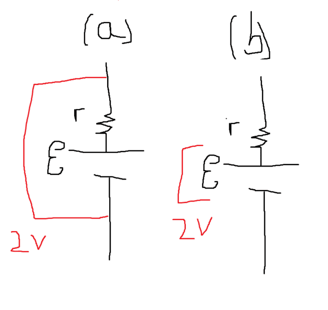

Does the voltage across a battery include its internal resistance?
8 replies · 1K views
laser
104
See description
V=iR
I am uncertain if this represents situation (a) or situation (b).
i.e. is 2 = E-iR or is 2 = E? Or is the question ambiguous?
Thanks!
laser said:
Homework Statement: See description
Relevant Equations: V=iR
Thanks!
Is the r in your diagrams a representation of the internal resistance? If so, it is (b).
The actual voltage on the terminals depends on the current, so it would not make sense to call it a 2V battery if it meant (a).
Yes
Just to add on to that: Battery voltage (or any voltage you measure really) is measured with a voltmeter connected to the terminals. The voltmeter has a large resistance as to not interfere too much with the measurement - an ideal voltmeter would have infinite resistance implying zero current through it.
Amperemeters are the opposite, they are connected in series in the circuit which you measure and need as low resistance as possible not to interfere with the circuit. An ideal amperemeter would have zero resistance.
Edit: Fixed typo.
How would you envisage measuring the value ξ in diagram b? You'd have to put the probes 'somewhere' in amongst the electrolyte and electrodes. emf is a value of potential difference when no current.is being taken. Internal resistance is just a mental construct which gives a value to the amount of energy dissipated inside the battery for each unit of charge that passes through. We don't know where the loss occurs and nor do we find that the value of r is the same for all currents. r is a handy value to tell us things like how 'good' a battery is and what sort of load it will support.

The "ideal" battery we usually choose to use for analysis is the Thevenin equivalent of the "real" battery which is in fact more complicated internally..
