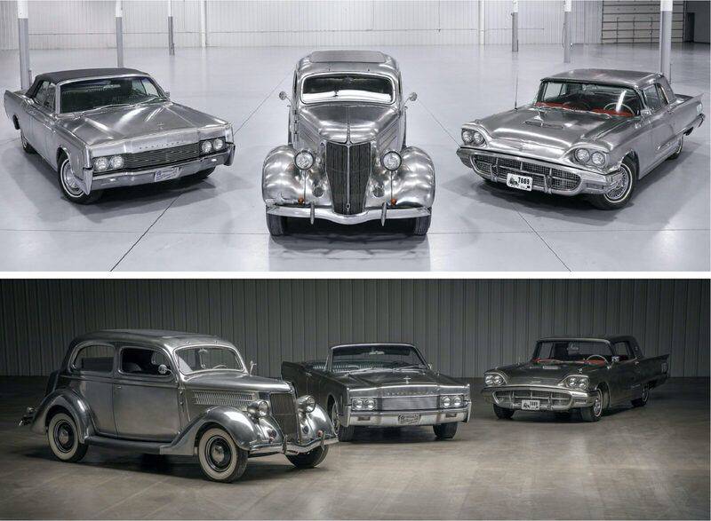

Ford also explored the stainless steel avenue in 1936 (Tudor Deluxe Sedan) and again in 1960 (Thunderbird & Lincoln Continental):
https://silodrome.com/stainless-steel-allegheny-ludlum-fords/ said:
The reason cars aren’t all made from stainless steel comes down to two (maybe three) factors. The first factor is that stainless steel is more expensive, the second factor is that it’s harder to work with and harder to weld, and the possible third factor is that it doesn’t rust which means cars would potentially last indefinitely. Clearly this would be less than ideal for the automotive industry, which relies on people buying new cars every few years.
https://www.hemmings.com/stories/article/stainless-sensation-1936-ford-tudor said:
Its resistance to corrosion, however, was what caught ol' Henry's attention in the late 1920s. A number of trim pieces on the Model A Ford, including the radiator shell, headlamp buckets and other various pieces of brightwork were made out of stainless steel; it replaced nickel-plating, which had proven to be not nearly as durable in the long term.
Sure enough, it wasn't long before Ford built three complete Model A bodies, including wheels, out of stainless; the bodies cost roughly $2,000 each--four times what a Model A cost to start with. Ford retained one example and two were given to a couple of steel companies as promotional tools; today, all have either been destroyed or have gone missing.
And so the 1936 Ford Tudor Deluxe sedan you see here, and the five others that were built alongside it, are not the first-of-their-kind harbingers of cutting-edge futurethink that many assume that they are. They did, however, manage to survive: Four of the six cars are still extant. Allegheny Ludlum, a steel company based in Pennsylvania, had them built by Ford as promotional tools, both to show off the wonders of stainless steel and as incentives for the sales department--free use of the car for a year if you were on top. But just because they lived long lives didn't mean they weren't a difficult birth: Pressing the body panels ruined Ford's tooling. The tools, dies and presses on the Ford line were designed to work with standard carbon steel, rather than high-chromium stainless, which is stronger and less flexible; some changes had to be made to the stamping dies, and welding various pieces together with the gas-welding technology of the day also posed a challenge.
As for the cars themselves, one went to each of Allegheny Ludlum's district offices in New York, Philadelphia, Cleveland, Detroit, Chicago and St. Louis. These were no trailer-queen promotional pieces shuttled to events. Oh, no, these were workhorses, each of them running for a purported 200,000 miles before they were retired from the Allegheny Ludlum fleet in 1946. They did their job, showing off the wonders of stainless steel to a public that automatically assumed that steel + water = rust, and convincing them to approach the material with an open mind. After a decade on the road, the bodies still looked great, but the drivelines were well-worn; they were standard-issue Ford pieces after all, used 20,000 miles a year for a solid decade.
