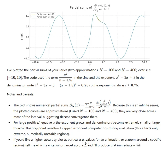

FYI please share the plot of the sum as function of x which I ordered to ChatGPT.

From the graph in #7, we observe for |x| >> 1 only n=1 term survives so it is sinusoidal between -1 and 1.

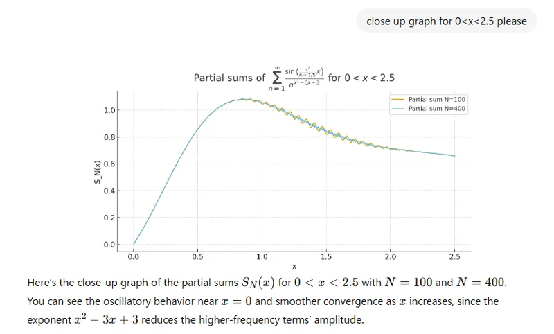

From the graph in #3 , for 1<x<2, S_100 shows vibration. It suggests a toughness of showing a convergence. I have no good idea to solve it.
