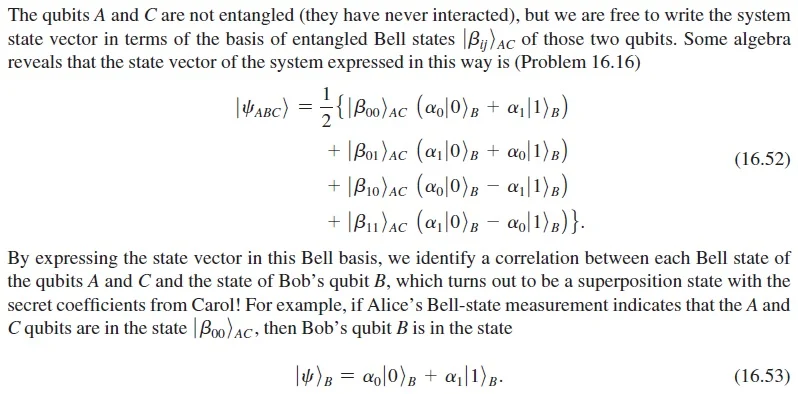

  • #41
Sambuco said:
The "entanglement" in entanglement swapping, and especially in the delayed-choice version (https://arxiv.org/abs/1203.4834) is not an interpretation-independent fact about the quantum state of Alice and Bob's particles.
Careful. Write down any quantum state you like: whether or not that state is entangled is a mathematical fact about the state (whether or not it can be expressed as a product of states of subsystems--if it can't, it's entangled), and does not depend on any interpretation.
What does depend on the interpretation is what physical meaning is assigned to quantum states, and which quantum states are taken to be the "correct" ones to describe particular scenarios.
  • #42
Thanks @PeterDonis for your comment! I should have said "(...) is not an interpretation-independent fact about Alice and Bob's particles," without including the term "quantum state".
What do you think is best? Should I edit my post to avoid confusion for future readers, or should I leave it as is?
Lucas.

gentzen said:
Because it was unclear to me how one would model quantum teleportation in Bohmian mechanics (BM), I tried to find existing accounts of how it is done. The only one I found was the link I gave above (Quantum State Teleportation understood through the Bohm Interpretation) from which I took the quote:
Simply by noting the actual position (##x_0##) of the measuring device, the observer, near particles 1 and 2, immediately knows which wavepacket ##x_0## has entered, and therefore which state is active for particle 3. The observer then sends this classical information to the observer at 3 who will then apply the appropriate unitary transformation ##U_1\dots U_4## so that the initial spin state of particle 1 can be recovered at particle 3.
The first step to understand why things are unclear to me, is to understand why the quoted part is not valid in BM, based on my current understanding. The devil is in the details for me. If the goal would just be to model the actually performed entanglement swap experiments in BM, then it is perfectly fine for me to do postselection based on particle trajectories. But for the general case, where different unitary transformations are applied to the "receiving qubit" of the pair of entangled qubits based on measurement results, some modeling needs to be found that makes it sufficiently clear what actually happens in BM. Otherwise, one should not claim to have shown that BM is indeed able to account for this type of experiment.
This is a case where orthodox interpretations do make predictions, but BM has trouble to model the situation, and hence cannot make predictions. But note that the actually preformed experiments can be modelled with BM, and that the mentioned "postselection" occurs both in BM and in the actually performed experiments.

  • #54
Sambuco said:
In Mjelva's paper, the experimental results in Ma's paper are correctly predicted by taking each of the four entangled states that Victor could obtain after making a BSM ... after Alice and Bob measurements were completed (these states are found in eq. (5) of the paper). Everything agrees with the textbook formulation, taking into account the whole context, as you rightly pointed out.
[I don't think it is fair to repeat the full arguments we made over in the other thread in this one. But here's the Cliffs Notes version just to save time.]
Mjelva, after his (3) which I completely agree with, and then after the measurements by Alice and Bob:
"Alice and Bob’s measurements have the effect of projecting the state into one of the following four product states, each with probability 1/4... [4 Product States listed]... On any given run of the experiment, the total system will be in one of the these possible states."
Experimental contradiction of Mjelva: It is an indisputable experimental fact that NONE of these 4 states - and no MIXTURE of these 4 states - can ever lead to an entanglement swap. Every experimenter who has ever worked with PDC entangled pairs can explain why*. That's because normal Type I and Type II PDC produced photon pairs are NOT entangled (and therefore cannot be used for swapping)! They emerge natively in precisely one of the 4 Product States listed by Mjelva**. Accordingly, they require relatively complex/difficult steps to create polarization entanglement. You can randomly mix these 4 Product states (say from 4 different laser sources), and they still would not be polarization entangled unless they were first made indistinguishable.
*PDC details are so taken for granted, experimenters stopped explaining them 10-15 years ago.
** Note that these 4 are counterfactual states, not observed states. A measurement on photon 1 does not produce a specific change (either physical or informational) to photon 2. It must be measured first.

gentzen said:
1. Let me remind you that the current consensus is that Bohmian mechanics makes the same measurable predictions as orthodox interpretations, at least in the non-relativistic, non-QFT case.
2. Challenging that consensus feels close to "personal research" territory to me. That said, I also believe that this consensus is not fully correct:
3. But note that the actually preformed experiments can be modelled with BM, and that the mentioned "postselection" occurs both in BM and in the actually performed experiments.
4. I also studied "Picturing Quantum Processes" by Bob Coecke and Aleks Kissinger...
1. Don't believe I mentioned Bohmian Mechanics (although I can see why you might think I was including it). I don't feel I understand it well enough to apply the same arguments to BM. I know BM mostly is considered deterministic, but most advocates are careful not to ascribe specific intermediate states during state evolution. They follow orthodox QM on that: No result unless there is a measured result!
If Sheldon Goldstein (or @Demystifier !) ever made the same mistake as Mjelva has, I would definitely address it. Mjelva did specifically use the same [experimentally disproven] reasoning vis-a-vis MWI, which is absolutely forward-in-time-only in all formulations. But not all MWI advocates would necessarily agree with Mjelva's formulation - I'm not sure either way.
2. Experimental citations can't really qualify as "personal research". Somehow, I am about the only person in this thread citing well-accepted scientific teams and their papers.
For example: Mjelva as an authority? The reason his paper is worthwhile is simply because he dared to make explicit what many people already assumed - as responses here demonstrate. I thank him for that. But if someone is going to challenge me on his forward-in-time-only logic in a thread on retrocausality, it would be nice to hear from a suitable experimenter or at least a well-known advocate.
I would say Ma's delayed choice experiment is an example of causal (time) symmetry, regardless of whether you fully accept it or not. See here for a catalog of such. You know... from a well-known advocate.
3. All experiment science is "post-selection" (this should be obvious). You design a hypothesis on a specified dataset, perform tests using an independent variable, and catalog results that match the specifications... after.
Post-selected studies - what I would call the correct usage of the term - is where data is analyzed and a hypothesis is created after completion of the experimental study. This is an especially vicious trap in studies of medicine and human behavior where there are multivariate considerations. The Cochrane Foundation will not approve studies in which the hypothesis is published after data is collected. That generally doesn't happen in quantum physics, for the simple reason that the hypothesis follows established theory.
