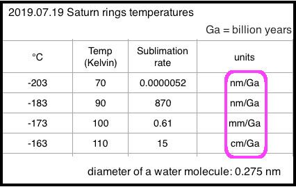

Heikki Tuuri said:
https://space.stackexchange.com/que...ctual-ice-on-the-moon-why-hasnt-it-sublimated
According to the discussion in the link, the ice sublimation rate per 1 billion years is negligible if the temperature is 100 kelvins.
Yay!
"The extremely low sublimation rate of an exposed block of water ice at ~100 kelvins would result in that ice thinning by a millimeter per billion years."​
According to my interpolations, ice thinning @ 100 Kelvin is 0.6 mm per billion years.
The rings of Saturn are at 100 kelvins. Sublimation will not destroy them until the Sun turns into a red giant.
According to the ESA, the rings range in temperature is 40 °C.
The upper temperature is interesting.
The ice in the astronaut is enclosed into tissues which can hold some water vapor pressure. The sublimation process at the distance of Earth will take very long, at least thousands of years.
I will take your word for it.
ps. I found this comment interesting; "...the evaporation ceases to be limited by pressure and depends only on temperature. This happens at about 1 Pa...". [ref]
