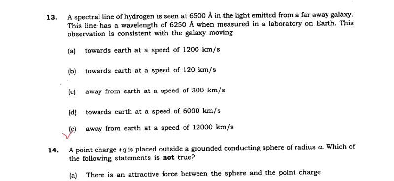

Doppler effect: finding recession speed from wavelength shift
6 replies · 2K views
Pushoam
961
53
When the source is not moving, ## \lambda = 6250 A ## ...(1)
When the source is moving, ## \lambda ' = 6500 A ## ...(2)
From (1) and (2),
## \lambda ' > \lambda ## ...(3)
This means that the source is moving away from the Earth.
## \nu ' = \nu \sqrt{ \frac { c+v}{c-v} ##
## {\frac { \lambda }{\lambda '} }^2 = { \frac { c+v}{c-v} ##
0.9245c –c = v(1+0.9245)
V =11760 km/s
Is this correct?
I hope you meant to write c - 0.9245c in the left-hand side. Otherwise the argumentation and the result seem fine.
I meant to write the following:
The following is wrong:
Pushoam said:
V =11760 km/s
The speed v is negative implying that the star is moving away from the Earth.
v = - 11760 km/s

Speed can never be negative as it is the absolute value of velocity. Whether the velocity is negative or not depends on which direction you defined as positive.
I had the impression that speed is a scalar quantity, which can be either positive or negative.
Now, I got to know that speed is defined as magnitude of velocity.
Then ## \vec v = v \hat v ## where ##\hat v ## is a positive constant unit vector and v could be either positive or negative and it has no specific name.
So, the following is wrong.
The correct one is :
v = - 11760 km/s
If you defined the positive direction to be moving towards the star, yes. Rounding the speed gives you one of the available answers.
