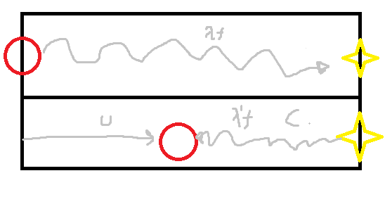

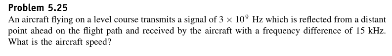

Printed text of Problem 5.25: An aircraft flying on a level course transmits a signal of 3 × 10^9 Hz which is reflected from a distant point ahead on the flight path and received by the aircraft with a frequency difference of 15 kHz. What is the aircraft speed?

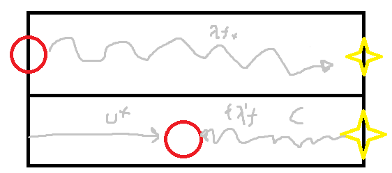

Two-panel sketch of a Doppler radar setup: top panel shows a wavy grey arrow from a red-circled point at left to a yellow star at right; bottom panel shows an arrow labelled u pointing right from the left, then a red-circled point and a wavy arrow labelled f' ƒ toward a yellow star at right.
u is the aircraft speed.
c is light speed
f is the initial frequency
λ is the initial wavelength
λ' is the apparent wavelength
λƒ = u +λ'ƒ
λƒ = u + (c/ƒ')*ƒ
c = u + (c/ƒ')*ƒ
u = c(1-(ƒ/ƒ'))
Equation u = c(1 − (3 × 10^9) / (3 × 10^9 + 15 × 10^3)), with u on the left and c multiplying the bracketed fraction.
u = 1500m/s
The answer is half of it, where is my error?

  • Printed textbook problem 5.25: an aircraft on a level course transmits a 3 x 10^9 Hz signal reflected from a distant point and received with a 15 kHz frequency difference; asks for the aircraft speed.
Remember that this is the reflected signal. So if it were measured at a stationary detector at the reflector, you would get one value. If it is measured at the aircraft which is moving toward the reflector, you get twice the value...
Sorry, I am not sure if i get... So my math equations is wrong? The speed i measured is what would be measured in the aircraft?
So the Doppler shift equation you used is for the shift observed by a stationary observer and a moving aircraft. But what if the observer is moving with the aircraft too? That makes the closing speed with the reflected signal how much bigger? :smile:
The aircraft will see ##f= \frac{c+v}{c-v}f_0 = (1 + \frac{2v}{c-v})f_0##, which means that the speed of the plane is, using ##f = f_0 + \Delta f##,$$v = \frac{\frac{\Delta f}{f_0}c}{2 + \frac{\Delta f}{f_0}} \approx \frac{c\Delta f}{2f_0} \approx 749.999 \text{ms}^{-1}$$i.e. very close to 750##\text{ms}^{-1}##, given ##\frac{\Delta f}{f_0}## is small.
