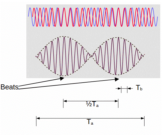

The waves sent by the bat and the waves reflected from the wall interfere. I thought that the net waves would be beats, which the bat then hears. I still don't understand why it hears a lower frequency...
See if this helps. I’ve taken a diagram from http://hyperphysics.phy-astr.gsu.edu/hbase/Sound/beat.html and added a few things.
The top part of the diagram shows two similar frequency signals (say ##f_1## and ##f_2##).
The bottom part of the diagram shows the sum of these signals. The pattern is a low frequency signal (frequency ##F_a = \frac 12 |f_1-f_2|##) modulating a high frequency ‘carrier’ (frequency ##F_b = \frac 12 (f_1+f_2) ##) as described in Post #11.
Left-to-right represents time. The periods of ##F_a## and ##F_b## are of course ##T_a = \frac 1{F_a}## and ##T_b = \frac 1{F_b}## which are marked on the diagram.
For humans (and presumably bats too!) the key signal that we would hear is the modulated signal, i.e. the signal of frequency ##F_a## enclosed in the modulation envelope (dotted lines).
Note that the lower diagram shows one full cycle - either dotted line is a complete sinusoid.
[EDIT: That's one full cycle of the modulation envelope.]
But what we experience during each period (##T_a##) of the modulating signal are two ‘beats’ (see diagram) corresponding to maximum amplitudes of the modulated carrier.
The time-interval between consecutive beats is ##\frac {T_a}2## so the beat frequency is ##2F_a##.
