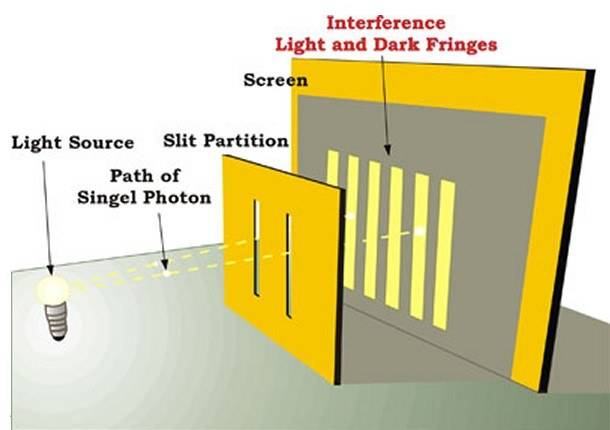

From : http://www.physicsoftheuniverse.com/images/quantum_double_slit_photon.jpg
I just want to be clear, I'm referring to the screen in this diagram, not the slit partition. I know the light has already interfered after the slit partition and before the screen. I am talking about what happens when the light hits a regular everyday object, like a screen (white surface).
As jerromyjon says, what happens after the screen/detector/film records the photon (or other quantum object) is essentially irrelevant. In the particular example you presented in your most recent post, the photon is reflected to a person's eye. But again, this has nothing to do with a double slit experiment's signature results.
