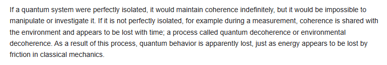

Thanx! I read about decoherence. Is it maybe something here that the cat actually makes this system "less QM"? You mix a mechanical world with a "QM world" and this makes the whole system "less QM" If you have my camera inside the box you make it even "less QM?" Its a "observer" a "meassuring device"? I will check that book, it sounds exactly what I need. Sorry for my ignorance.
https://en.wikipedia.org/wiki/Quantum_decoherence
No. Decoherence is still a quantum process.
But decoherence makes QM information being "lost" somehow?
PeterDonis said:
If you think someone is violating the PF rules against insulting other members, the correct response is to use the Report button, not to respond in kind in the thread. Nor is it correct to remark when you think someone has become "friendly" again.
OK. I am not saying anyone is being unfriendly anymore, quite the opposite.
It makes the phase information that would allow you to measure interference effects inaccessible, by spreading it among a very large number of untrackable degrees of freedom, usually referred to in the decoherence literature as "the environment". However, it doesn't actually have to be an external "environment". For example, a large macroscopic object like, say, a cat (a la Schrödinger) can serve as its own "environment": any information about interference between, say, two atoms in the cat is quickly spread among all of the cat's degrees of freedom and is thus inaccessible. That's what allows us to say that the cat is either alive or dead, and that when it dies, the death is irreversible--because the information about interference between "dead" and "alive" states of the cat is inaccessible.
