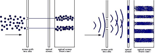

If you fire particles through two slits, you might expect to get only two lines and not an interference pattern. But if those particles are going through and bouncing off 'something', perhaps in a Brownian motion type way, you would expect to see an interference pattern. Nothing to do with 'waves'. And if you adjusted the size of the slits, that would also affect the interference pattern distribution, which I believe is also backed up by experiment. So why is there an assumption of wave like behaviour? I am not saying it is wrong, just trying to understand.

Thank you for the response. But I don't understand. The thing I don't understand is why some conclusions have been drawn from the experiment.
If you have a single slit, I would expect a particle going through to resemble a sort of Normal distribution.
Once you have two slits, I would then expect a result of either, two 'hills' or Bell shaped curves around the slits (if the slits are far apart) or several 'hills' with the biggest 'hill' in the middle of the slits. An interference pattern. This to me is nothing to do with waves or anything that is unexpected or wave like. This is what you would expect from a particle. Isn't this what we see in experiment?

That's what you get if the slit is wide enough. If the slit is sufficiently narrow, then the pattern spreads out into a diffraction pattern of light and dark patches.
This is what you would expect from a classical wave.
Note that when the slit is sufficiently narrow, the uncertainty principle comes into play.
This is not what you see. Again, the slits need to be sufficiently narrow and close enough together. You then get the two diffraction patterns overlapping and, crucially, interference is seen. What you see is not the simple addition of the two diffraction patterns. Instead, you see constructive and destructive interference.
This matches the pattern predicted by classical waves in a double-slit. The question is how a particle can interfere with itself? Quantum Mechanics provides the answer to that.

Suppose a particle that goes through slit 1 ( assume slit 2 is closed) sometimes hits point X on the detector screen. And, likewise, if slit 1 is closed and the particle goes through slit 2, then it also sometimes hits point X.
However, when both slits are open the particle may never be detected at point X. That's called destructive interference.
That's what happens in the double-slit experiment.

No, you wouldn't. Classical particles don't exhibit interference. Only classical waves do. That's why people naturally interpreted seeing interference patterns in double slit experiments as evidence of wave behavior.
For light that was not an issue, since light was already believed to be waves; but when experiments began to see such behavior for things like electrons, it created a problem, because electrons were believed to be particles, not waves.
Eventually physicists realized that none of these things are classical particles or classical waves; they are quantum objects that obey the laws of quantum mechanics, which are not the same as the laws of either classical particles or classical waves. So any reasoning you do about quantum objects based on either of those classical concepts--meaning all the reasoning you are trying to do in this thread--is simply wrong.

No, your expectation is wrong. A collimated beam of particles that obey classical mechanics would form only two bands on the screen behind the slits as per the left-side of the diagram below; i.e., there is no interference classically. But real particles obey quantum mechanics and exhibit many bands on the screen, as shown below on the right. That is quantum interference.

It's certainly not an assumption, it's just Newton's first (classical!) law: a moving particle travels in a straight line with constant velocity if it's not subjected to a force. That means that those particles that manage to get through one slit will simply propagate straight to the screen and form a band of exactly the same width as the slit. And two slits means exactly two such bands (and no more) on the screen.
