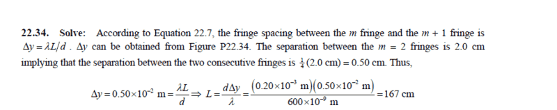

The figure shows the light intensity on a screen behind a double slit. The slit spacing is 0.20 mm and the wavelength of the light is 600 nm. What is the distance from the slits to the screen?

I have the answer there (attached thumbnail) from what the teacher provided, but I do not understand where 1/4 came from. Will someone please explain this to me? I am very confused. I am also confused on how the intensity diagram shown is used.

This is the model answer.
Would you be able to explain to me where the 1/4 came from? I understand every other part except for that.
And I now understand that the intensity is just to show me the .20 mm
I know that Idouble= I 1(4)
Would it have something to with that? If so, how?

First let me make clear what does this intensity diagram depict:
1) The maxima i.e, the tip of the mountain/curve signifies that at that position the intensity is maximum or, the path difference between the light rays of two sources is n[itex]\lambda[/itex]
2) The points where the graph touches the x-axis is where the intensity is zero, i.e, the paths difference is [itex](2n+1)\lambda/2[/itex]
3) Note that, the distance between the [itex]1^{st}[/itex] maxima/tip of the mountain and the [itex]5^{th}[/itex] tip is 2cm. And there are 4 gaps between the first and the 5th. So, if 4 gaps amount to a width of 2cm, then 1 gap is [itex](1/4)*2.0 cm[/itex] wide.
I hope you got it now. Do notify if you need any further help.
