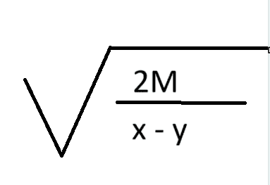

If two objects are separated at a distance and start from rest with a uniform acceleration, when will the object behind catch up?
Hey everyone,
I would just like to confirm if the following is correct:
If there are 2 bodies A and B and they both start from rest such that A is "M" meters behind B and once they start, they undergo a uniform acceleration of "x" m/s^2 for A and "y" m/s^2 for B, such that x>y, then A would catch up with B after:

You are correct.

Alright, thank you!
If you are going to post maths here, you probably want to read the LaTeX Guide, linked below the reply box. This:$$\sqrt{\frac{2M}{x-y}}$$is a lot more readable than your image.
Note that the first time LaTeX is added to a page the parser doesn't always kick in. If you see letters, back slashes and curly brackets instead of maths, refresh the page.
