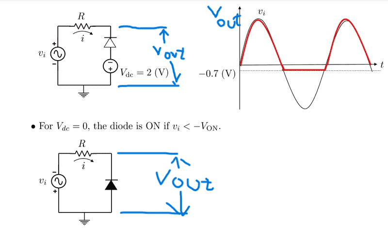

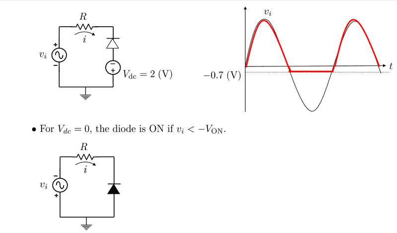

refer to the image
refer to the image
I have just started diodes .
What's ##V_{ON}## here? Could anyone explain what's going on in the graph? It seems like the one from the definition of half wave rectifier but shifted below the x axis by ##0.7##

@Bling Fizikst, this seems a bit unclear to me:
- is the required graph for ##V_{DC} = 2V## or for ##V_{DC} = 0##?
- what does the y-axis represent? I suspect it is the voltage across the resistor (essentially the 'load'); this needs to stated explicitly or the question is ambiguous/incomplete.
EDIT: The y-axis is not the voltage across the resistor. See @256bits Posts #3 and #6.

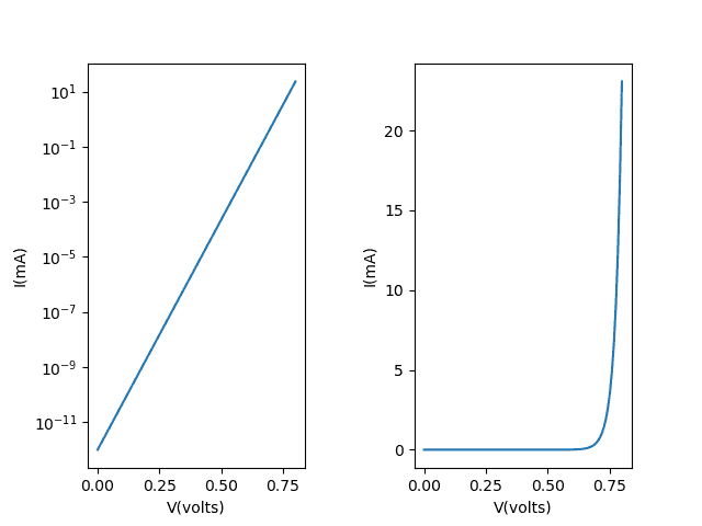

.Scott said:
An ideal diode would begin passing current as soon as there was forward voltage.
However, semiconductor diodes don't begin passing current until the forward voltage exceeds Von.
This is not true. Semiconductor diodes also begin passing current as soon as there is a forward voltage. However, the current is an exponential function of the voltage, so the current is quite small until the voltage gets large enough. The current as a function of voltage is $$ I = I_0 \exp{\frac{q V}{kT}} $$ Since kT/q is about .026V, the voltage needs to increase until approximately 0.7V until the current is significant. See the attached plots. The left one is on a log scale, the right one on a linear scale.

The resistor voltage is either 0 in the with the diode reverse biased, or v
i - v
diode when the diode is forward biased.
The graph does not represent the voltage across the resistor.
As I said in my post. I do agree the graph is incomplete.
But refer to my post for the representation of output. ie diode output
On the graph, the black line represents the source voltage, with the red line representing the diode output ( I should have edited the picture with red marker rather than blue ).
Not sure why the course has even have a valve diode symbol along with a silicon diode symbol in the circuit the top picture - with V
dc = 2v, and then eliminate the valve diode in the bottom circuit.
Would this be a common thing to do in a present day course explaining silicon diodes? hmmm!!!
i - v
I agree. I hadn’t thought it through. I had the typical teaching-scenario in mind - a supply, diode and load where we are interested in the voltage across (and the current through) the load.
