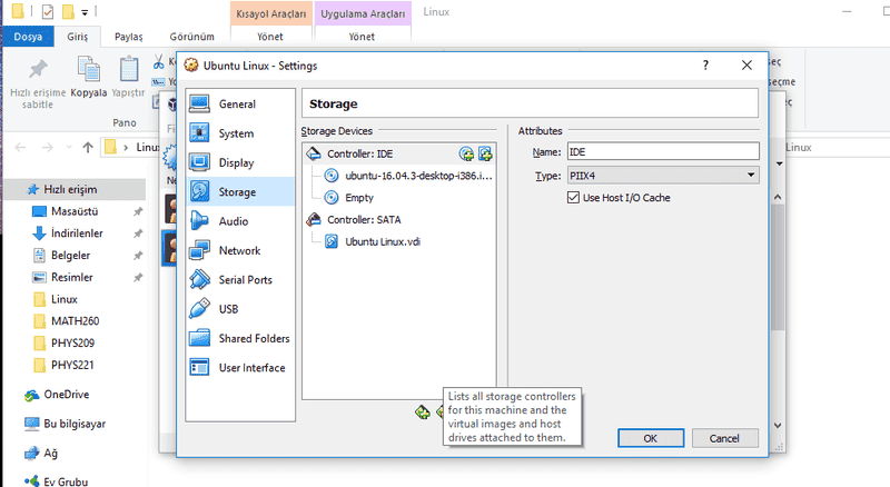

so this happens everytime I open the VM. so then I have to do this to make it work,
after adding it to the storage it works fine.

What does happen when you start the OS without mounting the .iso image? It doesn't boot?
This seems similar to your issue. Try removing the .iso image from the media manager, and restart the virtual box.

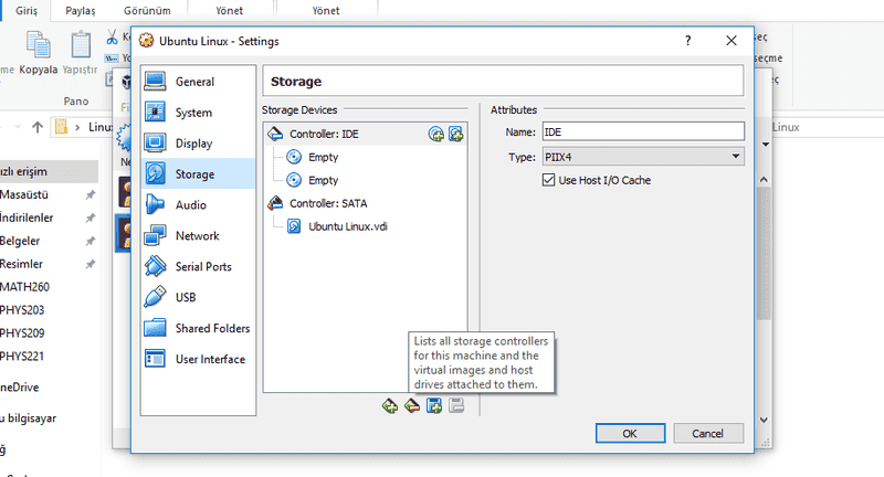

so that's nice I think then I started the program. It opened.Then I closed the all programs including VM. After that I re opened and It didnt give me the error but when I started the program it said
"No bootable medium found, System halted"
and when I look the storage it was like this again,

The storage should be empty. Go to setting->system, and make sure the Hard Disk in the Boot Order box is checked, and make it the first one in the list. See what happens.

Its not working that way..Maybe its because I am always choosing the try ubuntu instead of install ubuntu ?
Oh, you need to install it, yes. Try it is just to see how it looks like BEFORE you make the commitment to install it.
