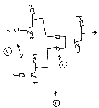

Draw a circuit diagram (using only transistors and resistors) showing how a 2-input AND-gate can be realized.
Component values are not required.
None.
(Refer to attachment for correct answer).
I am not too sure how the current would flow (from the beginning to the end of the circuit). At what point does the current originate (i.e. start)?
Why also is the output taken at the collector?

Write a truth table for the circuit operation, including the state of the intermediate outputs (at the collectors of the first two input transistors).
Do you understand how the common-emitter (CE) transistor stage works? What does the transistor do when its base is pulled high? How about when its base is pulled low?

The input bases are "pulled" high or low by the input signals. When the NPN transistor's base is driven high through a resistor, that causes the transistor to pull down (pull the voltage down) on its collector. And when you drive the base low, that turns off the transistor, and the pullup resistor on the collector pulls the collector high. So a single stage (like the two input stages in your schematic) acts like a NOT gate. Do you see that part?

It sounds like you need to learn a bit about basic Bipolar Junction Transistor operation:
http://en.wikipedia.org/wiki/Bjt
RTL operates the transistors in the saturated and cutoff regions.
In the following diagram:
[PLAIN]http://dl.dropbox.com/u/4222062/Transistor%20voltages.PNG
In circuit A you can see that the voltages in a series circuit divide so that the voltages are proportional to the resistances and always add up to the supply voltage. This is because the resistors both have the same current flowing in them and V= I * R.
Don't go on until you understand this and why it happens.
In circuit B the bottom resistor has been replaced by a transistor, but the transistor has no base current so it isn't conducting. It has a very high resistance compared with the 1 K resistor so the voltage across it is almost 12 volts.
In the last circuit, circuit C, the transistor now has a lot of base current and the transistor now behaves like a small resistance resistor. Can you see that the voltage across the transistor will now be small compared with the 1 K resistor, so most of the supply voltage will appear across the 1 K resistor?
If you disconnected the top of the 10 K resistor and connected this to 0 volts (the negative side of the battery) then to +12 volts, you can see that the collector will go from 12 volts to 0 volts. So it works as an inverter.

Now, how did you go with the AND gate?
If you mean how I think the current flows then this is what I say:
*In the beginning if Vin > 0.7 for the first inverter, then the IB will flow through the resistor, to earth, setting up the IC from positive rail to earth. Vc (output) = 0 (as all the supply-voltage dropped across the resistor).
*If for the second inverter Vin < 0.7, then IB = 0, thus IC = 0 therefore Vc = 1.
*For the NOR-gate, its first input will = 0 and its second one = 1.
*By the time these to inputs reach the common point at the base, the '1' will overide the '0', causing the final Vc of the AND-gate = 0 (as the transistor at the end switches on).
I think this is right, but please tell me if I am wrong somewhere.
That could work.
Having either input low would make the same transistor output high which should be enough to turn on the final transistor and give a low output.
Only if both inputs are high would the final transistor turn off, giving a high output.
