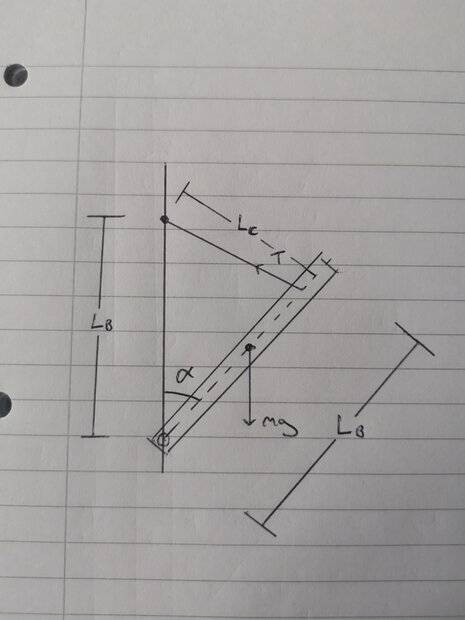

I'm currently looking into the forces exerted on a cable if the cable was to go from slack to taut due to a falling object that is pivoted about a lower hinge - such as a drawbridge but instead of slowly lowering, there is slack in the cable causing the bridge to freely rotate about the lower hinge before arresting by the cable once the slack is taken up.
I'll attach a rough sketch to visualise what I'm thinking.
I'm assuming that the bridge starts at angular velocity = 0 in the upright position before finishing as drawn. I'm also understanding that the cable must undergo some extension to calculate the tension based on the rotational kinetic energy, hence, there should be a spring constant type property for the cable?
Any guidance on this one will be much appreciated, thanks.

Yes, I would start modeling it as a spring with spring constant ##k## and add some lossy element like a dashpot. You can look up the ##k## and loss data for ropes like (dynamic) climbing ropes, where their behavior for the first few fall arrests is important. The spring and dashpot don't engage until the panel is at the angle where the rope would go taut.

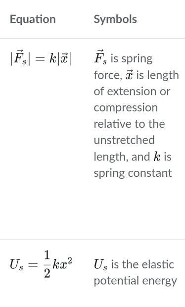

Would I be correct in setting the second equation equal to the rotational kinetic energy before rearranging for x. Then substituting this for x in the first equation where F would be the tension in the cable? Then find an appropriate stiffness value, k, to solve?

You have the right idea: Knowing the kinetic energy and the rope stiffness, solve for maximum deflection. Then substitute the maximum deflection into the force and spring constant equation.

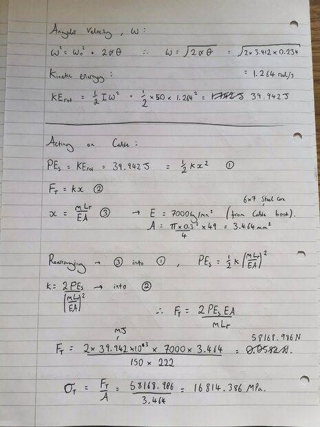

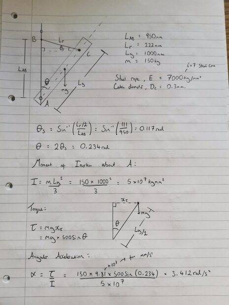

So, I've had a go at this with some example numbers and have come across some pretty poor results. I've either made a significant error that I can't spot or, the fact that cables don't obey Hooke's law has had a large effect on the final calculations.
I'll attach my working on this for now while I try and think of alternative routes to calculating the safety factor in this case.
Any help, recommendations or guidance will be hugely appreciated!

I rather suspect that the intention for this problem is not to model the rope at all, but to treat this as an impact problem. The rope is simply the means by which a force is suddenly applied to instantaneously stop the falling bridge.

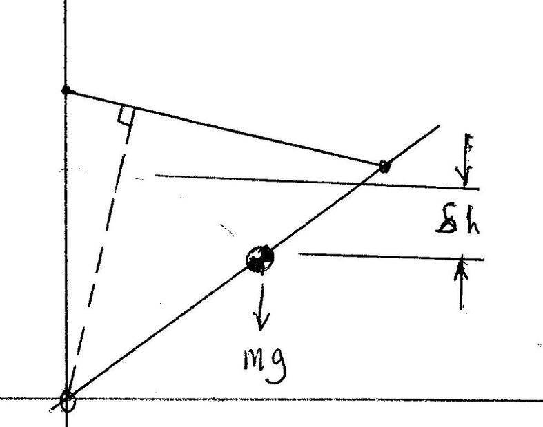

Problems combining linear and rotational motion can be challenging. In this case, the center of gravity (CG) of the drawbridge has an initial height, and a final height. The difference, ##\delta h##, is the vertical distance that the CG moves from the start of movement until stopped by the cable. That potential energy is equal to the kinetic energy at the instant that the cable stops the motion. The kinetic energy is rotational - ##0.5J\omega^2##, not linear - ##0.5mv^2##.
In a rotational system with a linear spring, the linear spring constant needs to be converted to a rotational spring constant. The same spring connected to a point near the center of rotation will have a lower rotational spring constant than if connected to a point far from the center of rotation.
The rotational spring constant has units of ##Nm/radian##, and is calculated from the linear spring constant and the perpendicular distance from the spring centerline to the center of rotation. The perpendicular distance is shown as the dashed line in the sketch above. The rotational spring constant ##K_r = K_sD^2##, where:
##K_r## is the rotational spring constant, with units of ##Nm/radian##
##K_s## is the linear spring constant
##D## is the perpendicular distance from the spring centerline to the center of rotation
Rotational spring impact calculations are similar to linear spring impact calculations:
Linear: ##0.5mV^2 = 0.5K_sx^2##, where ##x## is the maximum spring deflection.
Rotational: ##0.5J\omega^2 = 0.5K_r\alpha^2##, where ##\alpha## is the maximum spring deflection.
In a linear system, the peak spring force is calculated directly from the peak spring deflection. In a rotational system, the peak spring deflection is calculated from the peak angular deflection, the distance from the center of rotation to the spring attach point, and the angle between the spring centerline and the drawbridge. A careful diagram and trigonometry is needed. The peak force is then calculated from the peak linear spring deflection and spring constant.
