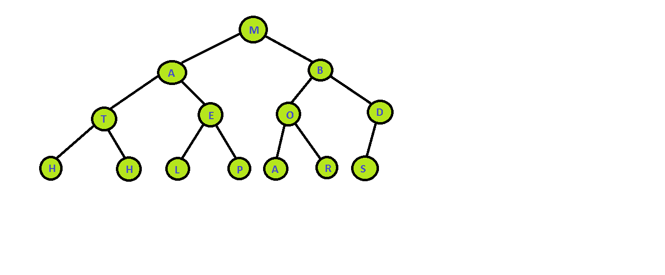

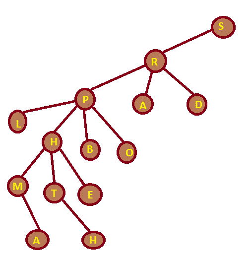

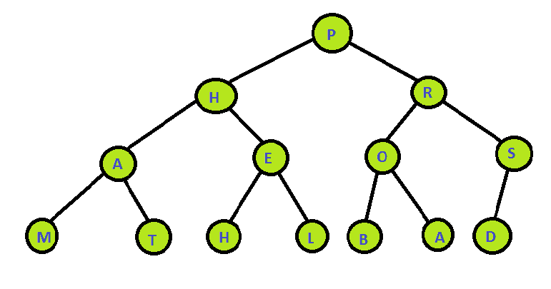

I want to draw trees, that traverse "MATHHELPBOARDS" in:
  • pre-order
  • in-order
  • post-order
That's what I have tried:
Could you tell me if it is right or if I have done something wrong? (Thinking)

evinda said:
Hello! (Wave)
  • pre-order
  • in-order
  • post-order
Hey! (Blush)
All of them are right! (Clapping)
Are they the only possibilities? (Wondering)

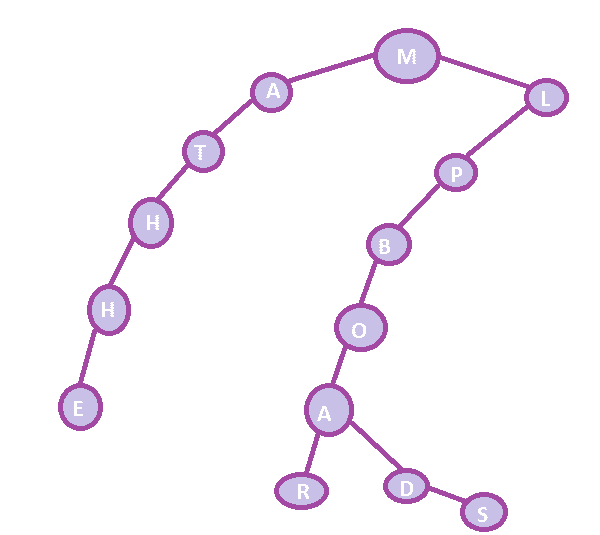

No, there are more possibilities. An other tree, that traverses "MATHHELPBOARDS" in pre-order is this:
Or am I wrong? (Thinking)
Nice! (Happy)
I see they are all binary trees.
Do they have to be binary trees? (Wondering)

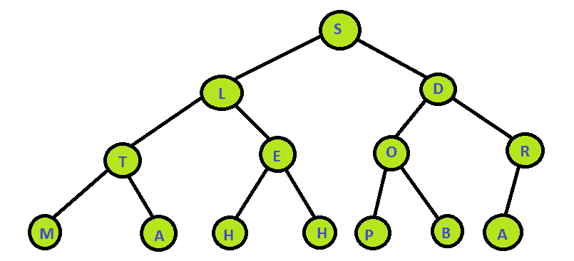

Is this a possible tree? (Thinking)
I don't think so. (Worried)
Why would M be the first node in this tree? (Wondering)
(Worried) With which node should I start then? :confused:
Well, I'm assuming that S is the root.
Or isn't it? (Thinking)
So if we do a pre-order traversal, S should be the first letter.
For a post-order traversal, L is the first letter.
And in in-order traversal is not properly defined for a tree that is not binary, but if it was, L would still be the first letter. (Nerd)
How can M be the first letter? (Wondering)

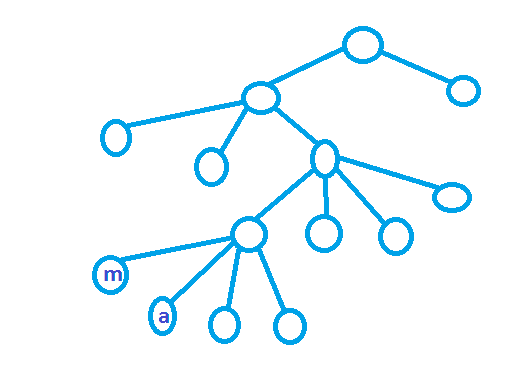

At the post-order, we have this row: left, right, root, right? (Thinking)
So, when we have, for example, this tree:
where do we have to put t? :confused:
Post-order would not start wit the 'm', but with the leftmost unlabeled node.
That is, it repeated takes the leftmost branch starting from the root until it encounters a leaf. (Worried)
Once we get to the 'm', the next node is indeed the 'a', and after that its right sibling. (Mmm)
