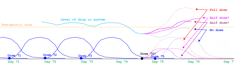

Yes, this is for me, and really, I'm just curious. I appreciate the caution, and will exercise due diligence.
As with all meds, they tell you to take the dose as soon as you remember. But taking a whole dose when the next dose will be in less than 12 hours will tend to over-dose somewhat, though not harmfully - it is a perfectly fine rule-of-thumb.
Also, I recognize there are many factors that come into play, I'm really considering the "all other factors being equal" scenario here.
So, what I've been trying to reconcile is:
1] These meds take a long time (days/weeks) to build up a therapeutic dose. This would suggest that each subequent dose is leaving a little behind in the body. That suggests the curve of a single dose is not truly a bell curve - it will rise normally, but drop off asymptotically. After enough time, any single dose (see BLUE curves on attached graph) will only be a fraction of the total dosage (see LIGHT blue line ) in the system. Is this generally correct?
2] A half-dose. What is the curve of a half-dose compared to a whole dose? Does it:
- RISE at the SAME rate as a full dose yet level off EARLIER (see BOTTOM PURPLE line).
- rise at a SLOWER rate than a full dose? (see BOTTOM MAGENTA line).
(The Full dose and No dose lines are merely there for reference.)
  • Graph of drug levels over days 71 to 77 showing dose curves and the total level in the system, with labelled Full dose, Half dose and No dose traces against a therapeutic dose line.
Yes, actually, reading your references helps too.
The curve is actually logarithmic - dropping by half with each passing unit time. In the case of my drug, its half life is 21-26 hours. So my graph is qualitatively accurate.
