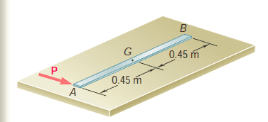

A force P is applied to the rod which rests on a horizontal table. The following accelerations are produced. aA= 3.6m/s2 to the right, α of the rod = 6 rad/s2 CCW. Determine the acceleration of point G and B
aG=aA+aG/A
aG=aA+[(aG/A)tangential + (aG/Anormal)]
aG=aA+[(α X rG/A) + ( ω2 * rG/A)]
So I tried to solve the problem and quickly found that there is no way to solve for angular acceleration (ω). Looking at the solution they completely leave out the normal component of acceleration to solve for the acceleration at G and A. They just plug in values for acceleration at A, angular acceleration and distance from A to G.
I can't figure out why there is no normal component of acceleration in this problem.
Any help?
Thanks!
is there a force parallel to AG?
No only the forces that are show. The evaluation of the question only involves the accelerations

Do you know how to work with the center of mass ?
Then why should there be an acceleration in that direction?
