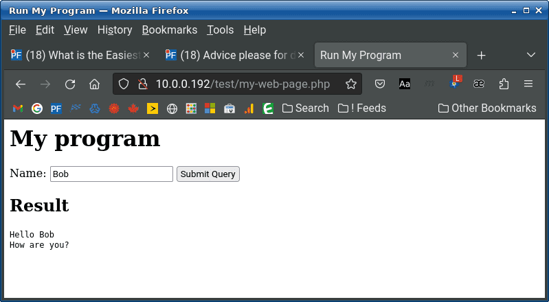

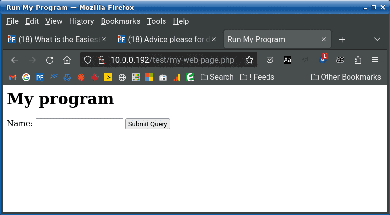

You can run your C++ executable and serve the results on your web page. For example, I created this C++ program and compiled it into a file named /var/www/html/test/a.out:
C++:
#include <iostream>
using namespace std;
int main(int argc, char *argv[]) {
    count << "Hello " << argv[1] << "\n";
    count << "How are you?\n";
    return 0;
Then I created this PHP file named my-web-page.php:
PHP:
<html>
    <head>
        <!-- Set the document title -->
        <title>Run My Program</title>
    </head>
    <body>
        <!-- Set the page title -->
        <h1>My program</h1>
        <!-- Create a form to get the user input -->
        <form method="post">
            <label>Name:
                <input
                    type="text"
                    name="input-name"
                    value="<?php echo $_POST['input-name'] ?? ''; /* Check if a value was already entered; if not, set to the empty string */ ?>"
            </label>
            <!-- insert a submit button for the form -->
            <input type="submit">
        </form>
<?php
    // Was there a value already entered?
    if(!empty($_POST['input-name'])){
        // Execute our executable program --> See https://www.php.net/manual/en/function.exec and https://www.php.net/manual/en/function.escapeshellarg.php
        $lastLine = exec('/var/www/html/test/a.out '. escapeshellarg($_POST['input-name']), $output);
        if($lastLine){
            // print the result
        <!-- Print the subtitle -->
        <h2>Result</h2>
        <!-- Put the result in a preformatted text element -> see https://developer.mozilla.org/en-US/docs/Web/HTML/Element/pre -->
        <pre>
<?php
            // Print each line of the output array from the executed program
            foreach($output as $line){
                echo $line."\n";
        </pre>
<?php
    </body>
</html>
Screenshots (run in Firefox from an Apache server with PHP):
