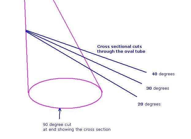

I need to visualize what the cross section is of an oval tube is at angles of 10 degrees, 20, 30 up to 60. Is there an easy way to do this online somewhere or is there a mechanical drawing trick that can be done to see this result?

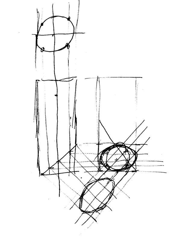

Here is the way I would do it.
View attachment 257263View attachment 257263
Thanks AZFIREBALL. This looks like it might work for me if I can understand it all. I will have to lay this out on graph paper. I am not sure what the right figure is. Can you expand on which drawing is what?

You need to be more specific and give a sketch of the tube and the direction of flow relative the tube and angled end cut orientation
Ok, here is a sketch attached.

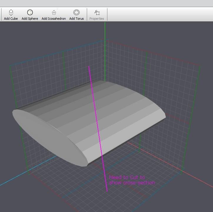

Tom, thanks for the link to the MeshMagic software. I loaded it and played with it for over an hour. I don't figure these things out easily. I finally got to draw a 3D oval tube as shown below but I don't see any way that this program will allow me to cut a cross-section and look at that cut as a 2D face. I added a proposed cut line to the screen shot with my photo editor program.
I don't have the program and the site documentation is sparse. They also have a pay version of the program (about which I also know nothing), that may have documentation.
If the program can do slices in arbitrary planes, that would be the simplest.
Can the program do intersections of objects? For instance have the oval tube pass thru a wall (flat plane) then inspect the shape of the result. Perhaps the tube should be a solid for this approach so the area on the plane can be subtracted, thereby showing a hole of the desired shape.
