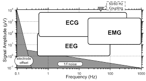

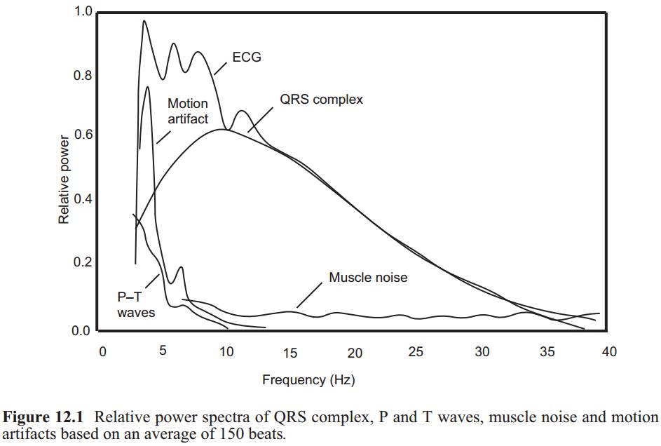

The first shows the power spectra (that is, plots of the energy content within each Hz of frequency span) for the ECG and for its primary components, together with those for a couple of the significant noise sources. The second plot is a kind of schematic showing the regions of frequency (not power) spectra that several physiological sources occupy, together with those for two noise sources that define the "noise floor."
Yes, that is what I was asking about. But what is a physiological source that of an ECG that has frequency? Heartbeats have a frequency, but that is not the frequency of ECG.
I look a bit more and it seems to me that the frequency is the frequency of ECG analyzed with Fourier transform. So is this true? And what is the physical(physiological) meaning of that frequency and of this analysis in this case?
Yes, a spectrum results from taking a Fourier transform. The Q wave arises from atrial contraction, the R wave from ventricular contraction, and the S-T signals from ventricular relaxation (repolarization). The frequency components basically reflect the speeds with which these events occur. Trying to diagnose heart disease from the ECG spectrum has not proven particularly useful despite lots of research and attempt.

A P-wave takes a certain time to rise and fall - the time period. Frequency is simply given as 1/T(ime period). So the P-wave contributes that frequency component to the spectrum shown in your first picture.

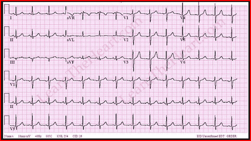

You can see the waveforms from a typical 12-lead EKG (or ECG) below. The sampling bandwidth of your data acquisition system needs to be high enough so that you can see all of the features of the waveforms, and low enough to limit the noise that comes into the sampling and ADC system.

Basically, the "speed" with which the waveform changes determines its frequency components. Imagine making up the waveform with bits of sine waves of differing frequencies--low frequencies for the long and rounded T wave, high frequencies for the short and spiky R wave. These correlate to what you see in the spectrum.

Basically, yes. But it is more accurate to say that the bandwidth of the ECG processing and recording circuittry must be wide enough to accurately follow the ECG time domain waveforms.
