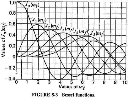

If you look at the spectrum analyser picture (sinusoidal modulation is what to use) you will see various features.

If you have a time domain recording then you can give yourself the same information that a spectrum analyser shows you. You should look at a lot of different images of FM spectra that you can find all over the web.
Firstly, if you use a low modulating frequency with 'high' deviation (Hz per Volt of the modulating signal) you will see "angel's wings" with an almost continuous looking spectrum spread over a range with peaks on either side. The separation of those wings is an indication of the deviation and the total spread is the bandwidth of the signal. Precisely how this image is the result is a complicated business. Different spectrum analyser settings can produce different images but no need to worry too much about that.
Secondly, if you use a high modulating frequency and 'low deviation' , the spectrum will consist of identifiable lines which are spaced by the frequency of the modulating sinusoid. For very low modulation, you see just two 'sidebands' and the signal looks much the same as AM.
FM sidebands theoretically extend to infinity but of course you can limit the channel width, depending on what distortion you are prepared to tolerate. If you google Carson's Rule you will find a formula which tells you that the total required bandwidth of an FM signal.

The display on a spectrum analyser will not tell you the deviation for just any signal. You can measure the 'occupied bandwidth' (between half power frequencies) of you can use the Bessel Zero method for calibrating low deviations. Anything a spectrum analyser can do can be done with computer software but you have to know what you actually want.

When you are presented with a spectrum - as in the diagram below - with a range of sideband amplitudes. You then need to 'work backwards' from the Bessel graphs (below) to decide what deviation will give you measured sidebands lying on the appropriate Bessel curves. Do-able but an awful lot easier to approach it the other way round and show that the sideband levels are right for a chosen deviation. There will be software to do it for you, I'm sure.
