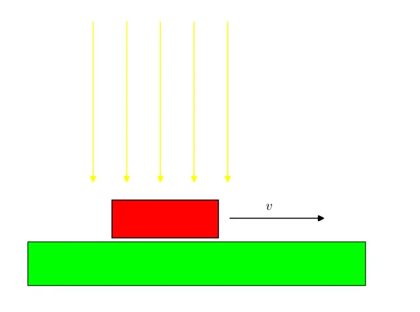

A 1 kg mass slides over a frictionless floor at a speed of 10 m/s. The mass has a top surface area of 1 m². The floor is uniformly irradiated with an intensity of 1 W/m², and the radiation is perpendicular to the floor in the floor’s rest frame. All incident radiation is absorbed by the mass—there is no re-emission.
My question is: Does the mass slow down in the rest frame of the floor?
If the radiation is absorbed by the object, then its mass must increase. And, by conservation of momemtum, it must slow down.

In addition to @PeroK 's answer in #2:
In the reference frames where the body is instantaneously at rest, the radiation is not perpendicular to the floor, but has a component that pushes the body backward (aberration).
Edit: It is analogous to the Newtonian problem of a bucket sliding under a perpendicular rain.

same question but then for the red mass not receiving radiation but only emitting radiation, so effectively loosing mass. Does the mass then speed up in the rest frame of the floor? (I think it will keep its speed)
It depends on the details of how it emits the radiation. If it emits isotropically in its own frame, then no. If it emits more light to the left in its own frame then yes it will accelerate to the right.
It is the same situation. One has to pay attention to the direction of the emitted radiation. If the radiation is vertical in the rest frame of the floor then the object must lose mass and gain speed. If we shift to the [instantaneous] rest frame of the object we see that the emission direction must be angled slightly rearward.

If the direction is uniform in the frame of the emitter then it will be non-uniform in the frame of the floor.

If the radiation is uniform in the frame of the ground, it must be angled rearward in the frame of the emitter. If the radiation is uniform in the frame of the emitter it must be angled forward in the frame of the ground.
Your new hypothetical is that the radiation is uniform in the frame of the emitter. So the latter applies. It must be angled forward in the frame of the ground.

Assume the radiation is uniform in the emitter's frame. In that case, there is no acceleration in that frame. However, from the perspective of the ground, the radiation is not uniform. How can you explain that there is no acceleration in the ground frame?
Indeed, in this situation, there is no acceleration of the emitter in either frame.
We have an emitter with constant velocity and decreasing mass. Its forward momentum is declining.
We have a forward-biased cloud of radiation with constant average velocity equal to that of the emitter and increasing mass. Its forward momentum is increasing.
Note that a cloud of radiation can have a positive total mass despite being comprised of massless individual bits.

Yes. If the radiation is isotropic in the frame of the emitter then it is not isotropic in the ground frame. In the ground frame the emitter loses momentum and the radiation gains momentum.
The emitter does not accelerate in any frame. It loses momentum in the ground frame by decreasing mass while maintaining the same velocity.
