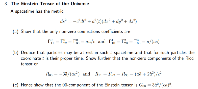

(a)Find Christoffel symbols
(b) Show the particles are at rest, hence ##t= \tau##. Find the Ricci tensors
(c) Find zeroth component of Einstein Tensor
Part (a)[/B]
Let lagrangian be:
[tex]-c^2 \left( \frac{dt}{d\tau}\right)^2 + a^2 \left[ \left(\frac{dx}{d\tau}\right)^2 + \left(\frac{dy}{d\tau}\right)^2 + \left(\frac{dz}{d\tau}\right)^2 \right][/tex]
Euler-Lagrangian is given by:
[tex]\frac{d}{d\tau} \left( \frac{\partial L}{\partial (\frac{\partial x^{\gamma}}{\partial \tau})} \right) = \frac{\partial L}{\partial x^{\gamma}}[/tex]
Applying Euler-Lagrangian to temporal part:
[tex]\frac{d}{d\tau} \left( -2c^2 \frac{dt}{d\tau} \right) = 2 a \dot a \left[ \left(\frac{dx}{d\tau}\right)^2 + \left(\frac{dy}{d\tau}\right)^2 + \left(\frac{dz}{d\tau}\right)^2 \right][/tex]
[tex]\frac{d^2 (ct)}{d\tau^2} + \frac{a \dot a}{c} \left[ \left(\frac{dx}{d\tau}\right)^2 + \left(\frac{dy}{d\tau}\right)^2 + \left(\frac{dz}{d\tau}\right)^2 \right] = 0[/tex]
This implies that ## \Gamma_{11}^0 = \Gamma_{22}^0 = \Gamma_{33}^0 = \frac{a \dot a}{c} ##.
Applying Euler-Lagrangian to spatial part:
[tex]\frac{d}{d\tau} \left( 2a^2 \frac{dx^{\gamma}}{d\tau} \right) = 0[/tex]
[tex]2 a \dot a \frac{dt}{d\tau} \frac{dx^{\gamma}}{d\tau} + a^2 \frac{d^2 x^{\gamma}}{d\tau^2} = 0[/tex]
[tex]\frac{d^2 x^{\gamma}}{d\tau^2} + \frac{2 \dot a}{a c} \frac{dx^{\gamma}}{d\tau} \frac{d (ct) }{d\tau} = 0[/tex]
This implies that ## \Gamma_{10}^1 = \Gamma_{20}^2 = \Gamma_{30}^3 = \frac{2 \dot a}{ac}##. Am I missing a factor of ##\frac{1}{2}## somewhere or is the question wrong?
Part (b)
I can't see why the particle is at rest in this frame. From the transport equation, the change in vector ##V^{\mu}## when transported through length ##\delta x^{\beta}## is:
[tex]\delta V^{\mu} = -\Gamma_{\alpha \beta}^{\mu} V^{\alpha} \delta x^{\beta}[/tex]
Letting ##\delta x^{\beta}## represent the time component and ##\alpha## represent the spatial component:
[tex]\frac{\delta V^{\mu}}{\delta x^{\beta}} = - \Gamma_{\alpha \beta}^{\mu} V^{\alpha}[/tex]
The LHS represents 'velocity' while the right hand side represents ##\int \hat r dt##. The Christoffel symbols are clearly non-zero: ## \Gamma_{10}^1 = \Gamma_{20}^2 = \Gamma_{30}^3 = \frac{2 \dot a}{ac}##.
Hint: Note that both ## \Gamma_{10}^1## and ## \Gamma_{01}^1## occur in the equations of motion ##\frac{d^2 x^1}{d\tau^2} + \Gamma_{\mu \nu}^1 \frac{dx^\mu}{d\tau} \frac{dx^\nu}{d\tau} = 0## .
Part (b)
You need to show that a free particle that is initially at rest will remain at rest in this coordinate system. So, you need to show that when a particle is released at rest it's spatial acceleration ##\frac{d^2x^k}{dt^2} = 0##. See if you can show this from the equations of motion ##\frac{d^2 x^{\gamma}}{d\tau^2} + \Gamma_{\mu \nu}^\gamma \frac{dx^\mu}{d\tau} \frac{dx^\nu}{d\tau} = 0## and the known values of the Christoffel symbols.

Analyzing the x-component:
[tex]\frac{d^2 x}{d\tau^2} = - \frac{\dot a}{ac} \frac{dx}{d\tau} \frac{dt}{d\tau} = - \frac{\dot a}{ac} \dot x \left( \frac{dt}{d\tau} \right)^2[/tex]
The only way this is zero is if either ##\frac{dx}{d\tau} = \dot x \frac{dt}{d\tau} = 0## or ## \frac{dt}{d\tau} = 0##.
I believe there is a missing factor of 2. Your equation for ##\frac{d^2 x^{\gamma}}{d\tau^2}## in post #1 was correct. (But your conclusion that the ##\Gamma_{10}^1##, etc., should have a factor of 2 was incorrect.)
We are considering the instant of time when the particle is released at rest in this coordinate system. So, you know the value of ##\dot x## at this instant.
So we say that if ##\dot x = 0##, then ##\frac{d^2 x}{dt^2} = 0##. Then to show for higher powers, simply differentiate the RHS which leads to more powers of ##\dot (x)^n## which are all zero.
Yes. So, if ##\dot{x} = 0## at ##t = 0##, then you get ##\frac{d^2x}{d\tau^2} = 0## at ##t = 0##. You then want to check that this implies ##\frac{d^2x}{dt^2} = 0## at ##t = 0##.
