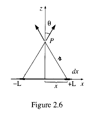

From 2.1 :
$$E={1\over 4\pi\varepsilon_0}\;{2\lambda L\over z\sqrt{z^2+L^2}} $$ for a point P at distance z above a linear charge:
You
  1. translate to the case of the problem (use ##z'## in the expression of the example):$$z'{\,^2} = z^ 2 + \left (a\over 2\right ) ^2$$where I think you miss something already, but I'm not sure
  2. maintain the ##{1\over 4\pi\varepsilon_0}\;##
  3. Consider the directions of the ##z## component and the ##z'## component
  4. multiply by 4
If you do all that I think you'll come out right :smile:

In case you didn't notice, the picture stands on it's side. My head does not :wink:
For this exercise, integration is not necessary -- that was already done in the example.
